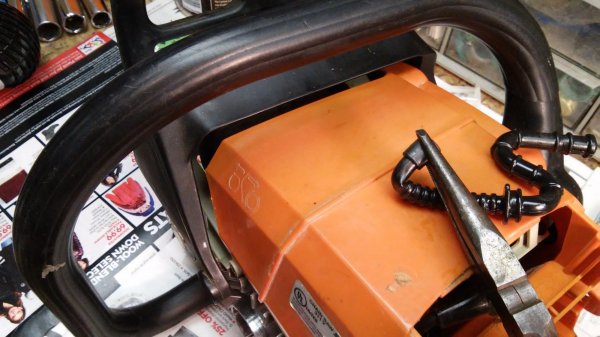

    How about a cheap aftermarket fuel line that came as part of a "Coil kit". I needed that coil but ended up buying a "kit" with a few extra "tune up" goodies included. I got the saw all put together after a lot of work and it would not run. I could pour a little gas down the carb and it would run nice for a few seconds and then die out. Kept fooling with the new "goodie carb" too thinking the problem was there. Even hooked a syringe up to the fuel line to see if I could draw fuel, it seemed a little slow coming. I had already cleaned the tank vent but I worked on it a little more. Tested the new "goodie" impulse line to make sure it was working right. Everything checked out perfect, but I could just not get it to suck fuel and run, or so it seemed. I pulled the new carb off to try the old one instead and just happened to push the fuel line a little just right and noticed it bent quite easily. I bent it 90 degree to the position of service and there it was, a dam kink. That aftermarket line is different enough that it will kink right next to the ribbing on its normal bend instead of holding a curve. Buyer beware! Damm, got me again! :headbang: I'm going to pick up a new OEM one Monday and see where that gets me!

    I have had two aftermarket ones for 1127 saw where the grommet would not seal and allowed the tank to leak fuel. Stihl brand was fine.
    Ran one on the ms650 that came on the hultz tank. 6 months or so it split where filter attaches. Right now I'm on another hultz line and its been there 18 months so good so far

    Yep, I had a couple AM fuel lines for the 1127s that I was not happy with. They also would kink easily.

    That was it! I got a new line from a dealer this morning and installed it. It was slightly longer and thicker than the aftermarket. Poured a little gas down the carb, put the air filter on, and started pulling on high speed no choke. After about a dozen pulls it coughed, started running after 3 more pulls. The gas started to run down after 6-7 seconds, but just when I thought it was going to quit I got throttle. Yes :dex: :yes: . That brand new "coil kit" zuma carb saw gas for the first time and took right off. Tuned it up for its new quadra-ported muffler mod and its ready to cut some wood! It sounds awesome! :thumbs:

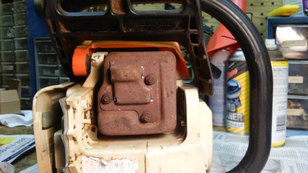

    No, this is the old "boat anchor" MS390 I was working on in the "360 vs 390" thread. I'm going to finish that thread after I run the saw a bit. Stihl MS390 versus MS360, Worth Fixing the 390 up? | Page 8 | Firewood Hoarders Club

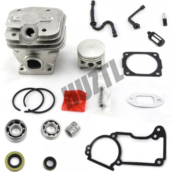

    You got it. Not a huge stash, just this from a different Chinese vendor. Its that fuel line that caused the problem kinking so I wanted to point it out here in the "Aftermarket parts" thread.
