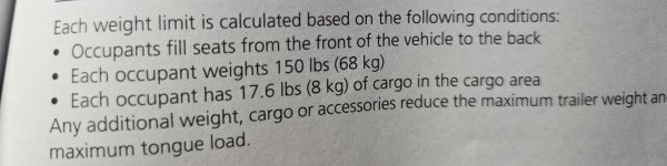

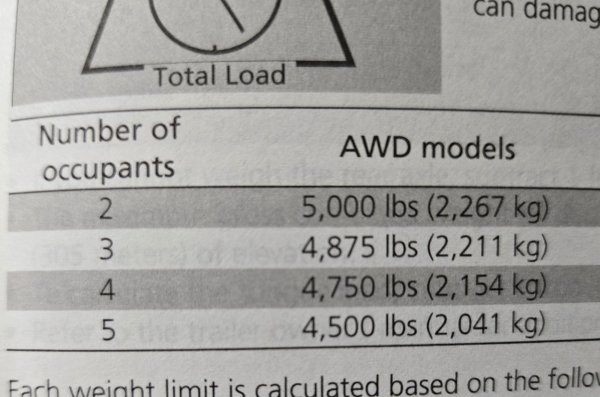

    The manual clearly states otherwise.

    That's very odd. No other manufacturers do it that way. But at least they specify that the two front seaters are 300 lbs total

    I wasn't talking out my azz or making it up. I own the vehicle and read the manual. :handshake:
