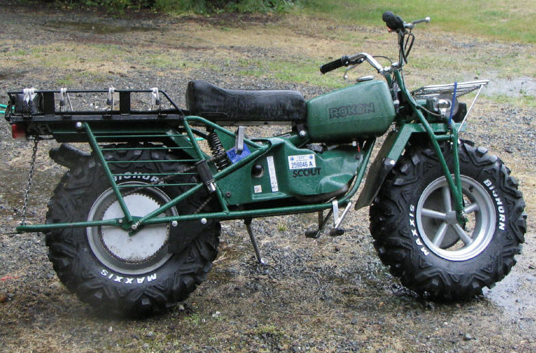

  19. MasterMech
    9,648
    26,044
    Greenville County SC
    That's not his Rokon but similar. Just a Google'd pic for those of you out there scratching your head wondering what the $^&* a Rokon is.... :thumbs:
    clemsonfor likes this.
