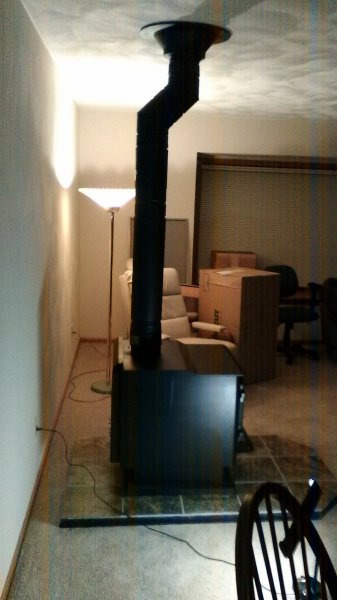

    Similar to mine , screws in top and bottom edges-not in middle- anything there leaves burrs and then you can hardly collapse or expand it. Learned that the hard way a long time ago. the sliding portion is just below the 2 45's
