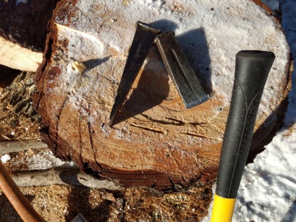

    A smaller round split with my small wedge. I went down the middle and not the side because there were knots on both sides. Anyway, it split easily. I just had to add a bigger wedge to get it apart completely. IMG_20191219_40657.jpg
    With this big trunk butt, I couldn't get a wedge started on the edge of the round. IMG_20191219_48123.jpg

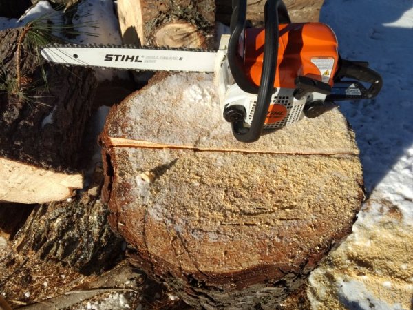

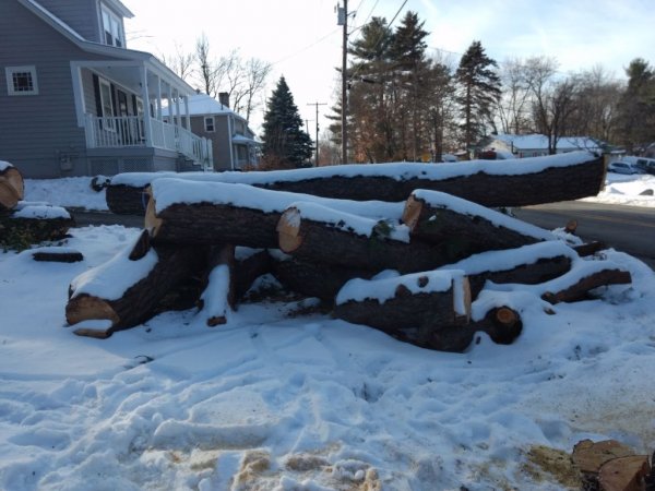

    It eventually came apart with several wedges. Forget to take a pic with the wedges in. IMG_20191219_9149.jpg
    So, in conclusion, it was a easier to split smaller rounds when frozen, but those big chunks don't want to come apart in any weather. And I got nowhere with my splitting axe, above or below freezing.

    Your splitting axe might work better now that the chunks are smaller.
    And no. No, there is no dis-honor to chain sawing a kerf first. :)
