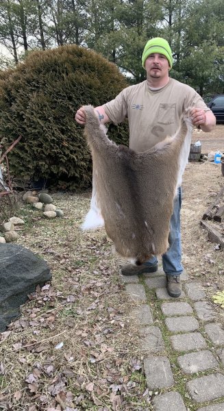

    151582DF-99A7-4D39-8FE6-B17BE024997A.jpeg We saved the deer skin/fur from our last roadkill and I’d love to know how to tan the hide. Has anyone here done this? I have a few country skills books on the topic but love hearing from “real” people how they do it. Nick laid it out back up on some junk to start drying but some critter ended up stealing it from us a couple weeks later. LOL

    Don't leave it out!! You need to freeze it if not going to do it now. If not the hair will "slip" or fall out as it basically started to rot and the hair follicle on the back side will loose their grip. But he is correct you need to completely flesh the hide, you can look in a book or just watch YouTube for the process. You have to remove all of the tissue from the skin on the non hair side. Fat and remaining muscle. You can brain tan with the brain (called brain tanning) but at this point I'm guessing you no longer have the brain or head and it sounds like it's been days so it might not be any good anymore. At this point your going to have to buy chemical tanning stuff from a place like McKenzie taxidermy supply or just Amazon or ebay. Follow those directions then you hang to dry once treated in that process. Then you will have to work the hide over a taught rope or a still metal edge or maybe vertacle mounted 1x4 . This I understand takes hours. Grab handfulls about a foot apart and work it meat side down over the surface you choose pulling it side to side sliding it over the edge. Keep moving around the whole hide till every part is done. This is what makes it soft. The more you do it the softer it is.
