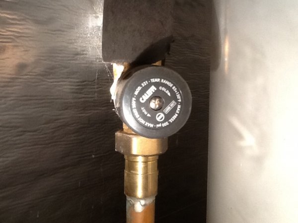

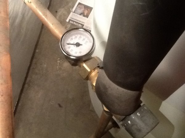

  3. DaveGunter
    DaveGunter
    3,894
    22,936
    Set temp of the tank is 170, the mixer valve is set to supply 120 to the house by mixing in unheated water. Here is a pic.
