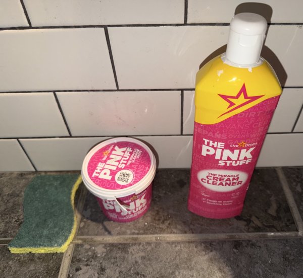

    It just seamed that our older powdered cleaner worked but nowadays there maybe a better way. So after some research I found the Pink Stuff and sold at Home Depot. It comes in Liquid and Paste. The paste is a little better for the tougher grime.
    Now the tools.
    Good
    1. Basic setup see the 1st pic
    Pink Stuff liquid & paste with the Scrunge Sponge from Home Depot

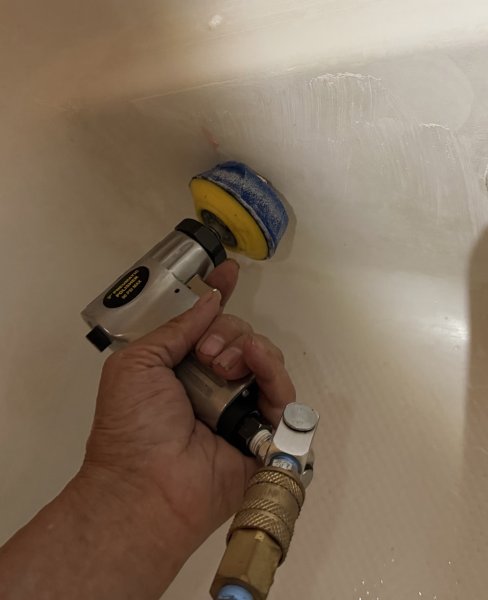

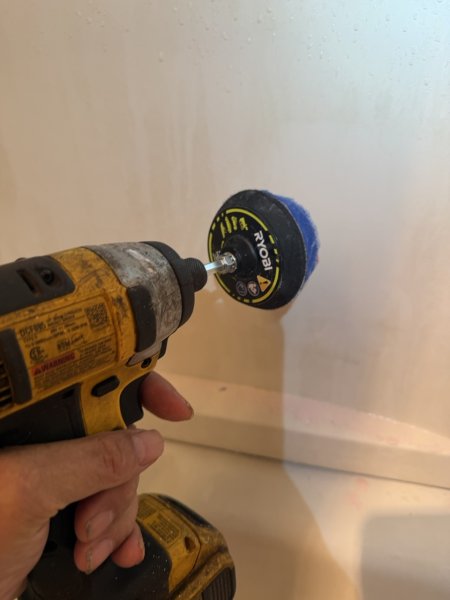

    2. Less expensive cordless drill setup
    DeWalt Brushless 20v Lithium Battery
    Ryobi Buffing & polishing drill attachment from Lowe’s The yellow and black foam pads work good.
    Medium cut blue compounding and buffing pad from Harbor Freight works better. (if 3” is out of stock the 5” pad can be cut to fit 3” polisher)
    Best
    3. Professional orbit higher RPM polishing & buffing tool
    Central pneumatic 3” Air Polishing kit
    Summary
    The basic setup works well but may need some elbow grease. The less expensive setup takes a lot of the elbow grease out and works well. The Pro air buffer setup is less bulky and higher RPM just cuts the scum in a whiz! an electric or battery buffer should work well to, they are just heavier.

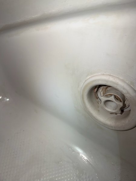

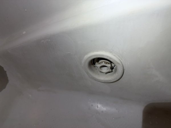

    The bottom of the tub is non slip so the dirt and grime hid between the bumps. However after using this, it is all white as snow!
    Last 2 pics are before and after.
