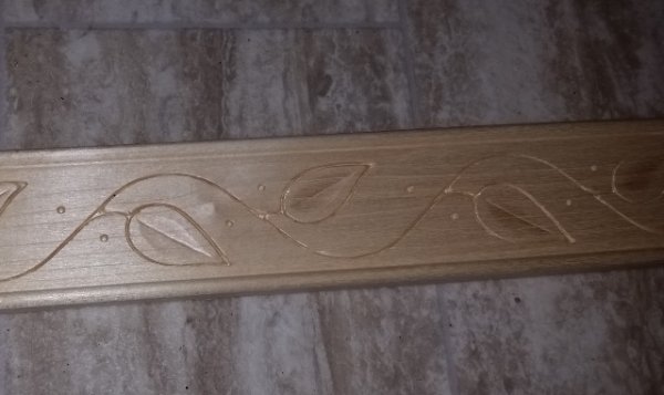

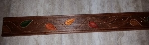

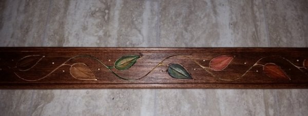

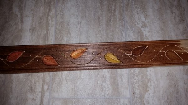

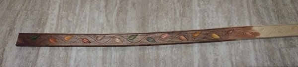

    Put these pics on the pellet forum, but thought I would share them here too. Am experimenting with coloring a piece of trim - mixing custom color "stain" for the leaves using markers then running the main color stain over the whole thing. The main color is a custom mix stain to match the bathroom cabinets and trim.
    This is just the practice piece as I have never worked with markers on wood before let alone mixing them to get more autumn leaf type of color. The panorama view makes it look like the wood is warped - but it is just me being a spaz while doing the picture.
    Bath finsh piece raw.jpg Bath finsh piece 1.jpg Bath finsh piece 2.jpg Bath finsh piece 3.jpg Bath finish piece panorama-sm.jpg
    Filling in those stupid dots is going to be the hard part and I haven't figured that out yet. Probably will be able to use a very fine paint brush. Not thinking that they should have any color but should have just the wood stain but am happy to entertain other's ideas.

    Very cool have never done that either "stupid dots" now bogieb how can dots be stupid ? Haaa could not help myself as far as what to do with them my first gut feeling (which dont me chit)would be for all of them to be a dark green ? Why hell i don't know . Try just staining them see how it looks , wont know until you try .
    Have seen this done before just curious what kind of markers ? anything special designed to do this or just regular markers , maybe Sharpe ? Do you clear coat after the markers to protect and seal it ?
    Just re-read it Panorama Spaz LoL I thought the wood was bent,warped !

    Was the trim already carved with the design or did you do that too? It looks really neat. I think whatever you do the main stem line with, you should do the "stupid dots" as well.

    I actually thought dark green too for the dots. I was also thinking a burnt orange or mustard yellow or even a dark bronze (the hardware in the bath is a Tuscan bronze). However, the markers are not sharp enough to get in there. The markers are Graffiti fabric markers that I already had. I would definitely put a good coat of polyurethane on it. I was unsure if the markers would survive the stain rubbed over them but they did, so assume they would survive the protective coating.
    The trim was already carved - got it at HD because they had the exact width I needed (1.75"). L*wes also has them in different widths. I wasn't specifically looking for patterned trim, it just happened to be exactly the width I was looking for and a pattern that I was okay with (there are other patterns, but nothing else I cared for).
    I tried to do the vines with markers, but again the markers aren't really sharp enough to get into them very well. If you look closely you can see darker and lighter areas on the vines - that is where I tried different colors but put in breaks so they would be easier to differentiate once I put on the stain. They are only a couple of hair-widths wide, so a very sharp brush will be needed. I'll probably have to go to craft paints for those.
    I do plan on experimenting and seeing if I can get those dots and vines filled in - just a matter of getting the paints and finding a time when I think I can color inside the lines again (very rare for me).
