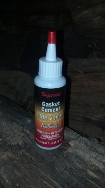

    I was going to try the Rutland furnace cement but found this stuff called gasket cement. Anyhow its fairly thin and I was able to slip the tip down in the groove and place a tiny amount in a few spots closed the door and left it for two hours and it seems OK now. Hopefully gets me through until I have a new gasket and the time to do it right.
    Locust Post and fox9988 like this.

    So far so good! Seems to be holding the gasket great so I'm going to let it go as long as possible. Ideally to put the new gasket on I would like to be able to remove the door and clean the channel it sits in.
