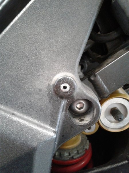

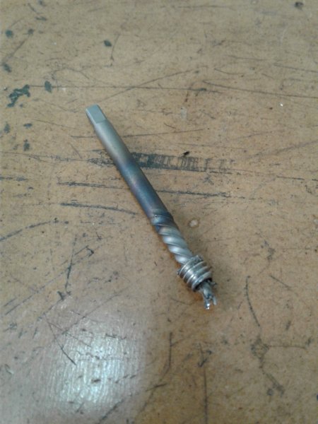

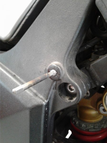

    If it spun even a little, I'd say a reverse drill bit @ slow speeds.

    Sorry, the bolt is for the coil on this saw.

    Ok so worst case if you were to grind a slot into it with a drimel and used a flat head to turn it out even if you cut into the aluminum a lil bit it wouldn’t be the end of the world. There should be enough thread there to hold it anyway. Just loctite it when you put it back.

    My thought exactly

    If the glue doesn’t hold and you are anywhere near Leominster I’d be happy to give it a shot with the welder if you like.

    all my ideas have been posted already. except this one: on my ford v-10 exhaust bolt i tried to weld a nut on technique. worked 95% of the time. the 2 bolts it didnt' work on I went in with a torch and heated the steel and blasted out the bolt. something about cast aluminum dissipated the heat. even saved the aluminum threads.

    I would sharpen an M6 screw to a point then tig weld it to the broken bolt. I use this when I can’t use the nut technique.

    I have had a lot of luck using that method. However, when I swapped the engine in my Suzuki TL, the broken off exhaust stud would not budge even after I welded and broke off 2 nuts. ( Lol, but seriously) I then had to drill it out, and helicoil it.

    A couple hours I’ll hit it with the benzomatic and see if the glue works
