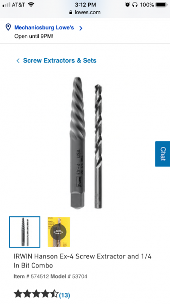

    Why I guess I did didn't I. I have a real dislike for them. I remove about 6 broken easy outs for customers a year. Plenty of better options available.
  6. Screwloose
    Screwloose
    Jan 15, 2017
    5,679
    33,689
    Any standard twist drill can be hand ground to cut in reverse, granted it'll be a little negative sorta like a brass/scraper drill. But it will actually transmit a fair amount of torque to the fastener.

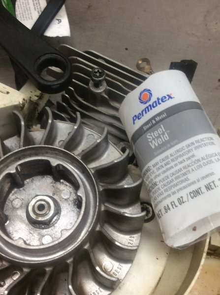

    And I may end up going through all of them before I go cigarsmokingzombie technique and wrap the thing a hundred yards away.
    This saw is haunted. I’ve been working on it off and on since the spring.
    I took my $30 Christmas gift card up to TS, not enough for mig welder, and bought 5 bux in glue.
    I over torqued it on rebuild, so it not seized on rust.
    I’ll wait the 24 hours, go down to the bench and snap it off with a T27 and go to step 2.
    With the tools I have, I think billb3 will be the next option on my bench.
    At 4mm OD on the threads, there’s not a lot of meat there.

    If that bolt was just over torqued and snapped off, then unless the threads started to strip/jam too, it will likely back out pretty easy...maybe with that "glue" (that's a big maybe) or chances are better that it can be "pecked out" with a sharp center punch and a small hammer to encourage movement...just centerpunch a spot close to one edge...then peck at that spot to try and get to turn CC.
    An automatic centerpunch works really well for this too...as long as the bolt doesn't turn too hard.

    This saw is a short lived unicorn MS280. I got it in a pile of saws and appeared to be straight gassed. Solenoid was bad. On rebuild I fworded the air dams. I was going back with new seals when this happened.
    Thanks!
    I’ve put more effort into this one than most and I appreciate the help!
    I’ll report back on the glue Hail Mary
