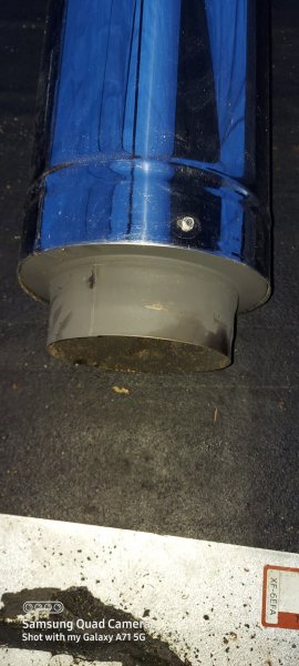

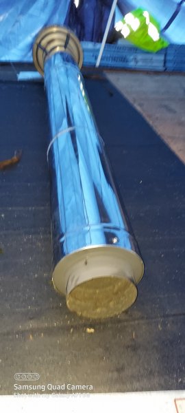

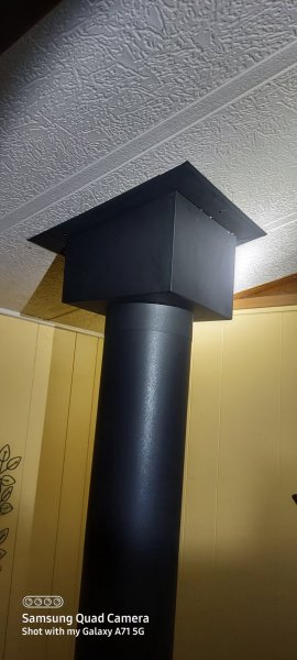

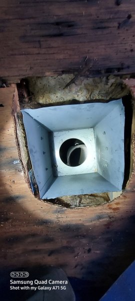

    Hi all had a lopi endeavor installed last year by a reputable installer locally and has worked awsome... I've been roofing my roof got to chimney and was very surprised how easy the chimney came out and pulled right out of the support box just curios was their any other hardware that should have been installed possibly got missed?

    What do you have dvl below the support box to Class A above it there?

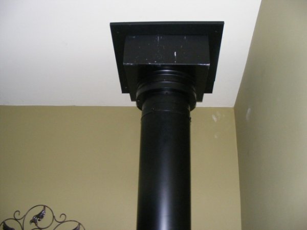

    HMMM! From the inside the house pic, your support box looks similar to mine. However, the chimney adapter at the bottom of the support box seems to be different in that the bottom of the adapter accepts the double wall stove pipe and the top of the adapter accepts the triple wall SS chimney pipe. The chimney pipe actually twist locks on to the adapter so you cannot just pull the pipe out. Rather it has to be unlocked to be removed.

    I was dry fitting my class A together today for install this week and thought of this thread. Depending on what brand you have, would determine how it is fastened together. It does not seem right that the Class A pulls right out. What is keeping the Class A from lifting from the flashing boot?
    The Duravent Class A here twist locks into the ceiling support box from the attic space. An adaptor with trim ring is fastened up into the ceiling support box from inside. The adaptor can be different if you have double wall (dvl) or single wall down to the stove.
    Do you have a sticker on the pipe to help determine what brand you have? Lots of folks here can help get it figured out. It may require a call to the installer.
