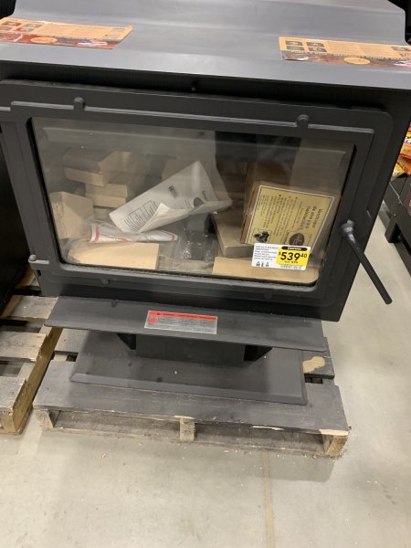

    8FAD029E-8EDF-4879-BDFC-FD884B38B1DF.jpeg These things are really a turd?

    That's the bigger model? Door issues was the main problem I think...at least after the other bugs were sorted out on early models...

    Yes says 2400 sq.ft. For 5 balloons I could just Craigslist it If it’s a POS

    True...is it scratched, or anything missing? Might be able to talk them down even more if so...

    At that price I would buy one knowing about the issues. The issues are, 1- draft; I think that if one has a really good drafting chimney, that might not be issue or as bad of an issue. Part of my problem is that I have a through the wall system and that does reduce the draft. 2 - the damper control; for that, leave the knob off and use pliers to help close and open. 3 - The doghouse is too far forward in the firebox; that isn't as bad but it will burn up sooner and you will be stacking logs on top of it; hot fires will burn it away shortly. the poor glass retainers; those you could get a metal shop to make better retainers so the glass doesn't fall out; the retainers barely hold the glass in place. If you are paying over a grand for a new stove with problems, then yes. However, at the price shown, then I would say get it, replace the retainers, have a good strong chimney and you would probably be OK. The stove does heat well.
