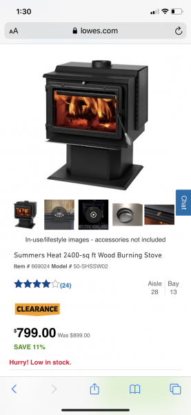

    594EA9AA-4BAF-431D-BF64-F5A2C87AA4B1.png This is the stove I am talking about

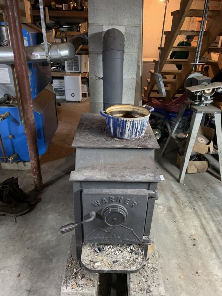

    449EAA44-2985-49D0-9EB6-ACDA6561522A.jpeg This is my current set up. Warner throws some serious heat but he is a hungry beast!

    The other totally different route I’m considering is an indoor gasifier tied into the forced hot water system you can see on the left.
    much more $$$

    800 is a good price; The Lowes here has it for $1,098.54. And if you can get it even cheaper. It might be worth it and you may have a stronger draft in your chimney if you put the liner in. See if they have one in stock so you can check the door seal etc. The stove heats very well, I keep the house a toasty 79 to 81 F degrees. Me, I hate the smoke issue I have but I have been told that any stove with a large door is going to spill smoke. I don't like the cheap glass retainers; they should have made better ones and replaced the ones on my stove but the guy was like "You will get the same ones." I don't feel like I should have to re-engineer a new stove. To me, if they would fix the flaws it would be a great stove. I haven't had the glass fall out again but it worries me for having overnight fires.

    Yeah that's the Madison 02...my recommendation would be to keep shopping...do they still have any of the Summers heat NC30 available?
