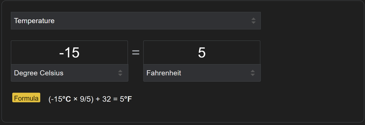

    I swap to winter around -15C or so.
    MikeInMa, metalcuttr, John D and 4 others like this.

  15. Nord
    Nord
    Oct 31, 2024
    284
    2,137
    Cote Nord, QC
    brenndatomu, Rope and John D like this.
