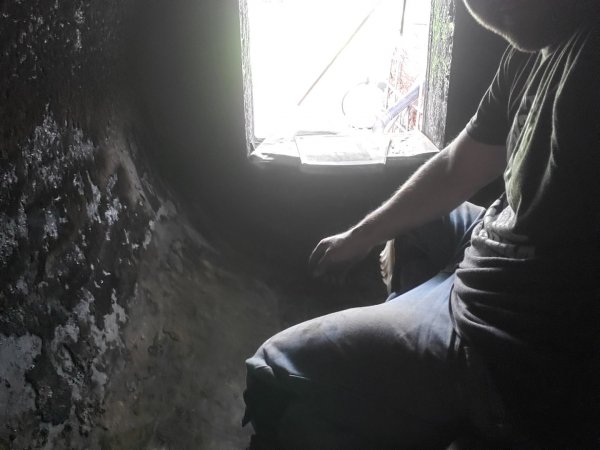

    After letting the fire die out for a week or so, I figured it was time to clean the owb for the summer. I shoveled out the ashes and vacuumed out what was left.

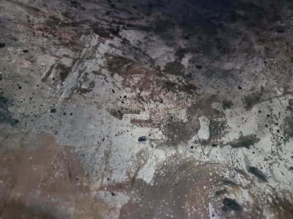

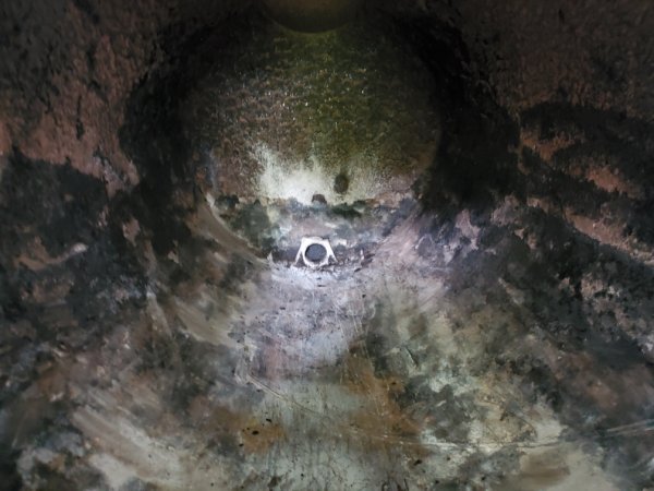

    I tried to get a picture of the pitting in this area, but it didn't really turn out. The corrosion is the worst under the chimney where the ashes and water meet. I swear ashes and water are more corrosive than salt on vehicles. summerize 22 5.jpeg summerize 22 4.jpeg summerize 22 3.jpeg

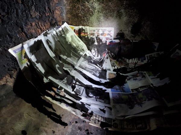

    I lined the bottom with used oil and news papers to minimize corrosion. summerize 22 2.jpeg
    I wouldn't believe it unless I saw it with my own eyes, paper NOT burned after sitting in an owb for a year. I guess it doesn't get enough air to ignite, then it get covered in ashes.

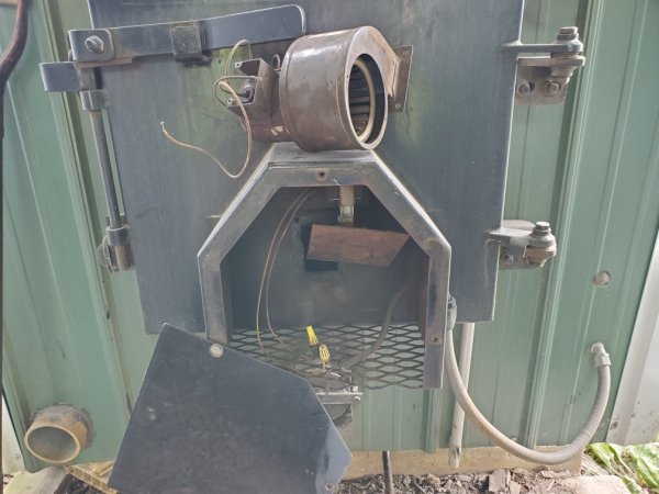

    Gotta pull the blower out of the door too. Also sprayed the motor with some WD-40. It helps prolong the life of the motor. summerize 22.jpeg
