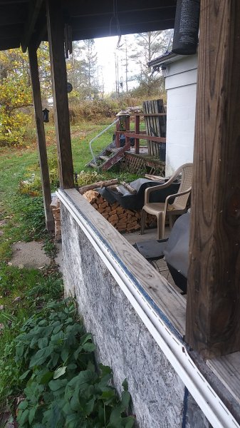

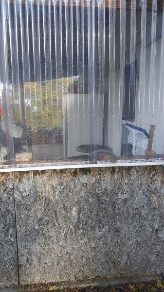

    bogieb I have a similar setup to what others said about the clear poly panels.
    When we bought this place, in the shed was huge 2x4 framed OSB panels with glass windows. Took 3 people to install.. Went that route the first year.. Then pitched them.
    I use J-rail along my railing (outer side) and screw the panels in at the top.
    Simple one person job in spring and fall.
    :rootintootin:
    Not sure what they want for the panels these days. BTW... I leave the lower OSB panels on year round.
    The J-channel can be left or removed. I overlap the panels as well.
    To cut the panels I put duct tape on both sides, and used a circular saw with a plywood blade reversed.
    Hope that makes sense.
    Otherwise those panels shred.

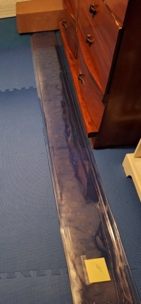

    I received the kits on 10/30. There were 4 boxes as I have 4 sections I am doing that each require a different length. well, to be fair, they probably would have used 4 boxes even if they had all been the same length because they get heavy pretty quickly. If things go right, they will be hung today - just in time to keep the wintry mix we are supposed to get tomorrow outside of the porch. Instructions say to lay the strips out on a warm floor for 24 hours before installing them (they come rolled up).
    Early yesterday morning I laid them out: "left" (90" long) and "right" (82") sections of the long side of the deck. These are the 12" wide strips that are heavy duty as they will be keeping out wind, rain, snow/ice.

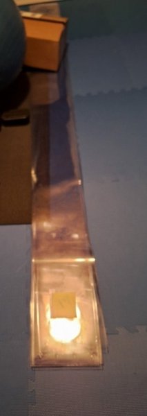

    Side by the door (94") and then strips that will go before the steps (96"). These are a bit lighter duty strips at 8" wide. The actual hanging of them will be interesting as the bracket will follow the slope from the roof. They are also not the priority as they will mostly just block the wind.
    It was interesting as they don't completely cut the individual strips off the real but do the partial cut so you can tear them off like a paper towels.

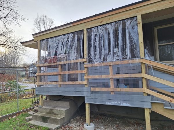

    The strips are up! They don't look as nice as full plastic panels would have, but there were challenges to overcome which the strips did nicely at alleviating. One of those challenges was I could not have put panels in front of the stairs - so that would creat a wind tunnel. I do need to trim a couple of strips on the short ends, close to the house so they can hang correctly, but they are functional as is. They handled the blustery wind we had on Wednesday, and did nicely at keeping the wintery mix outside yesterday, so I'm happy.

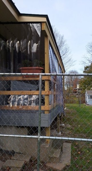

    This next picture shows nicely one of the challenges the strips overcome. The crew made the deck wider than they were supposed to. The support beams for the roof as well as the entire deck frame were supposed to be inset about 6". The post on that step should have been to the left, basically against the next step up - not on the outside edge of the step. That would have put everything nicely inside the drip line. The roof over the near portion has been there since 2017, so I know exactly where everything comes off the roof - heck, you can see it from the discoloration on the concrete step.
    Them not listening to me and enlarging it a bit didn't do me any favors, and unfortunately the error wasn't evident to me until too late in the process. At least I found a solution that at first blush seems to work well.

    Looks good. An unconventional solution to a problem that really works.
