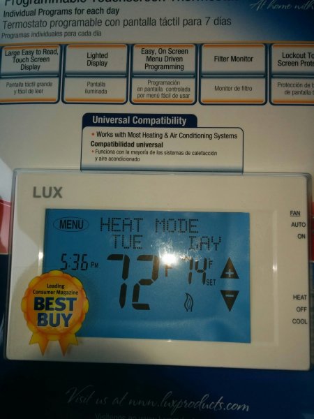

    What model Lux is that? I need a new one and I like the touch screen feature. My Hunter is touch screen, but only has a 3° max swing. Which is fine for the type of stoves I run, but my preference is to let the stove have a bigger break when running off/on mode. On High/Low mode, I typically run a 1°-2° swing. But the stove goes to low fire when the stat meets it's temp. Then once the temp drops, it goes back to the desired setting.
    That's the only flaw that the Cab 1200 has. If it had High/Low, it would be one of the best and easiest stoves to rum on the market. But it's On/Off only.

    That's correct it's the TX9600TS and so far I love it.
