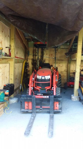

    Mine sat outside a year until I put up a pole barn (with the tractors help)
    At least now it's under cover with all the snow we get.

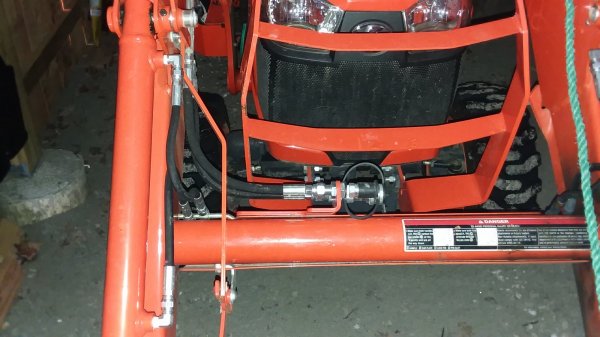

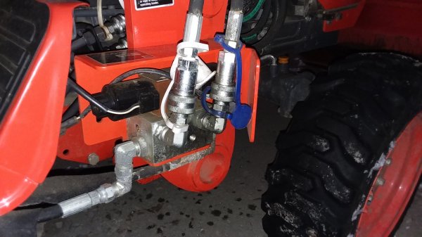

    Here's what the 3rd function kit looks like from front to loader valve.
    Connection for grapple, plow, etc
    The power beyond (not sure that's what it's called)

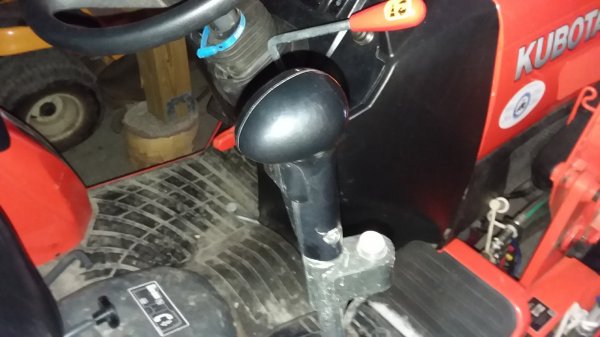

    And the loader valve. The push button turns on/off the 3rd function and the buttons turn plow or open close a grapple etc. Guessing your in the NJ highlands area? If so, your get your share of snow, so 3rd function would be helpful.
    I didn't get rear remotes. Just 3rd function, easily added if need be for the rear.

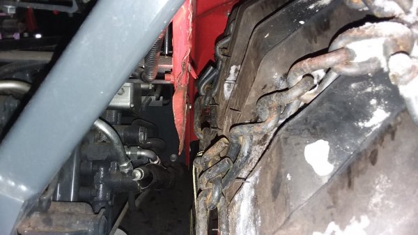

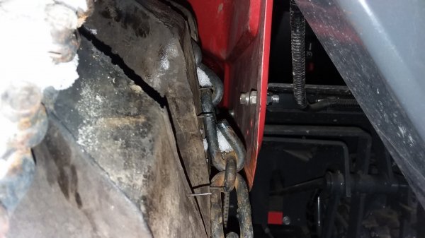

    Regarding wheel spacers..... get them, I wish I did! I've been saying that for a year, wishing I had them on when I bought the bota, but nope, not yet! Below you'll see how close the chains are to my fenders. In the second pic, you'll see the crumbled fender that I bent back into place when just a little bit of chain or a rock or something grazed it!
    They will give you a little wider clearance, and you'll be able to accept chains without any worry.
    Lucky so far......
    Not so lucky..... :rofl: :lol:
