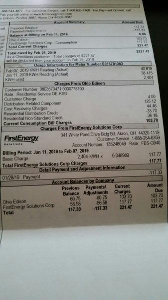

    Here you go, this is how "cheap" it is. Btw, if I didn't solely heat with wood, this would be 700 bucks or so. 2019-02-17 10.42.02.jpg

    $221.47 ÷ 2404 KWH = 0.0921¢ per KWH...still a darn good rate!

    We don't even see that price!! We just see that cost for the first 800 kwhr and the price for each kwhr after that. And then at the bottom they add on the town tax and the base rate.
    Yea that's still good!! That's like 30 to 40% cheaper than our Co Op. And they just got a ruling that there rates were illegal since they been building and charging us for a new reactor that they just abandoned last year after spending billions on it! We got a 15% rate reduction since they didn't deliver. And to make up for faying for the dam thing for almost a decade at this point.
