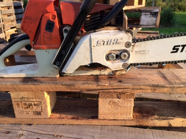

    Got some run time on both saws today. Here's some observations:
    Obvious since the 660 is only 2 years old, but the AV is a lot better with the newer rubber mounts and no "made to fit" components. The 660 is pretty smooth.
    The 064 absolutely rips. It's buzzy, but it's still breaking in and has a couple shadetree fixes for AV/handle stuff. Here's that broken clutch cover I mentioned:

    Not the safest and pretty ugly, but I'll be using this saw primarily to noodle nasty rounds from my tree service drop-offs. It's running an 3/8 x 8pin rim on a 20" bar as of right now... mainly because that's what I had on hand. So far I know I need to tap a muffler bolt hole for M6 since it's stripped out. I'm just happy this saw is alive (for now).

    The AM clutch covers are dirt cheap, and look to be exact copies of OEM, minus the STIHL logo.

    Yeah they are... seems to be good to go so far on my 660. I have one waiting for this saw from Huztl. I noodled a truckload of spruce and walnut yesterday with this broken one and didn't have any clogging issues. I may keep it on there for a while.
