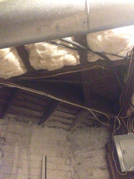

    Thanks fishingpol! I too have my popcorn out and am sitting at the edge of my seat! The Ideal Steel is listed on Woodstock's site as 620 pounds, but I see the works, which includes the soapstone liner and panels listed at 740 TurboDiesel, does that sound right to you? Do you think that I'll need extra floor support? As mentioned, my home was built in the 1890s, and they built things well back then - the beams in my basement seem pretty strong, but I would not want to push it and have a problem. Is 740, plus a bit more for a hearth extension, plus 60 more pounds with a full load of wood too much weight for a floor? It seems like that could be five fairly big people, and we've had some big parties with way more people than that, but not concentrated in one area, and not permanently! I'd love thoughts on this.

    Take a quick look in the basement to make sure things are sound, but as long as you are putting it near an outside wall or near a beam you can figure a lot of the weight will be transferred to the foundation wall.
    Also, being 3' wide, you are spanning at least 2-3 floor joists.
    Your brick flue may have a shelf to carry floor joists
    Let us know what you find.

    Thanks! I also just called Woodstock, and it turns out that it's about 640 or so with the soapstone. The 740 number was the shipping weight. I think my basement is sound and I even think the beams they used in the 1890s were heavier than the ones they use nowadays (now they sand them down to be less than 2" think but my are un-sanded and a full 2". I also think my brick flue has a shelf to carry floor joists, but I'll have to double check.

    I mentioned floor support as I have seen many older houses with cut floor joists in front of fireplaces. Then boxed in with smaller dimensional lumber to pour a mortar base below floor level and set stone or tiles in it.

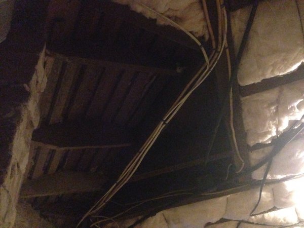

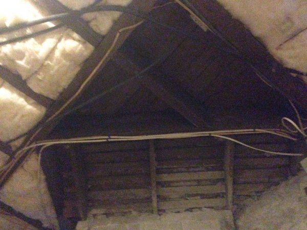

    Wow, fishingpol , I'm glad you pointed this out. I just went and looked, and seems like what you said. My basement has 2x9s throughout, with some 3x9s as well. These are at least every 16 inches (about 14 inches between each joist) but they're not all totally even and some are even a bit closer together. By the foundation of the fireplace, under the hearth, it is squared out (or actually more like triangled out) with the 2x9s ending a bit before they reach the wall, and smaller pieces of wood (perhaps this is the dimensional wood you are referring to), under t. Above that wood (dimensional wood?) is the brick foundation of the chimney underneath the length of the marble hearth, about 18 to 20 inches out from the wall (it curves so a bit hard to measure), and 56 inches wide at the wides part. The brick foundation also looks like it could use a bit of repointing, but I don't know if you repoint this area. The squared off area looks pretty well built, and again, the 2x9s and 3x9s throughout the basement are massive, a full 2 and 3 inches by a full 9 inches, as opposed to nowadays when the 2 inch piece is really 1.5. I'm attaching some pics here, though they may be a little dark - let me know if you need better or different photos. The pink stuff is insulation, but I removed that from the area in question to see what was going on. Is this something I should be concerned with? If so, is there anything I can do about it? TurboDiesel, I'd also love your thoughts on this.

    It looks like its built pretty well, but hard to tell from the pics
