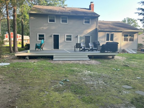

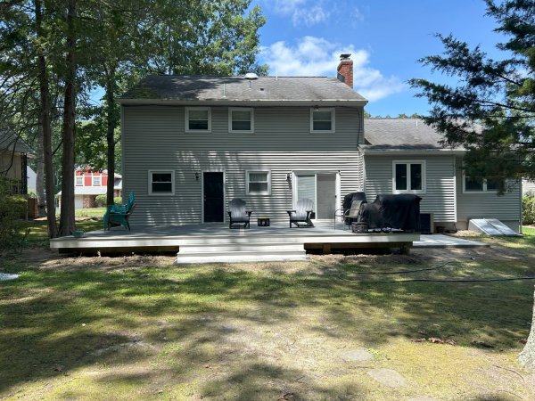

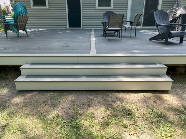

    I made out ok, thanks for asking :handshake: I still have a few plugs I am not happy with that went in wonky and kinda protruding up a little bit. I am very anal so I notice it more and irks me. I have to take some time ID them all (I'd say about 4-6) and drill out/remove the plug and drill out the stripped screw more and re-plug. I actually have bigger plugs I can use as well. In hindsight I wish I went with the trek fasteners, ugh :headbang:
    I am over my temper tantrum haha, I have to accept the fact there are mistakes and things I could have done better but when you just don't know you just don't know and I don't have the experience.
    In reality I relied to much on my brother in law, I should have educated myself more but I was lazy just relying on him. When I was left with the project I didn't take the time to educate myself more, and at that point I just wanted it done with.
    Overall I am happy with it, should last many many years and the good thing is he helped me with all the foundational work which is most important. I probably spent more than I needed with the amount of mistakes.

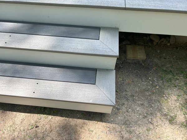

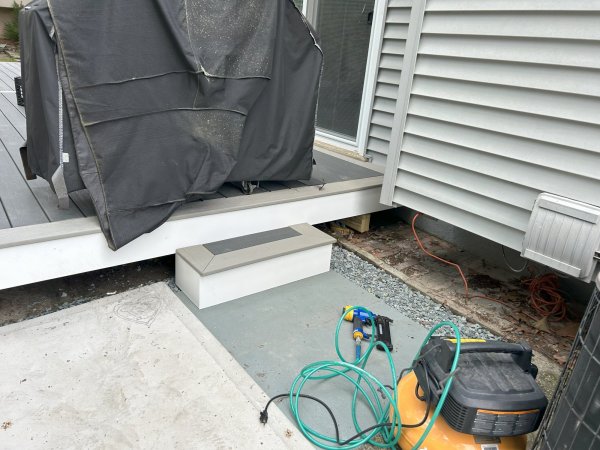

    I am also very pleased with how the front steps came out and the 2 side steps (there is steps on both side). I've never done something like that before and happy with results. I ended up buying a 12" miter saw used on FB for $60, older dewalt, thing was priceless on the miters for steps and a dam good saw cuts straight as can be.

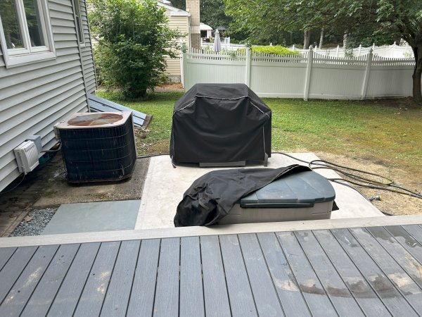

    I also decided to pour a 9x9 pad :rofl: :lol::rofl: :lol: granted I've never poured a concrete pad in my life, you know what frig it, I did it and it's not pretty but serves it's purpose as smoke/grill pad. Lot of work, wife helped a lot, we were in bed early that night and trust me it wasn't for some hanky panky. More like pass the pain killers and ben gay!
    My trailer was SCREAMING :bug::bug: with that load of concrete on it :rofl: :lol: That was a fun ride home but only had to go literally a few miles. I went early in the AM before the maniacs and congestion starts.
    Last thing we'd like to add is privacy walls along each side, front will stay open but that's another $1,500 so we are just waiting to recover from the summer vacations and a little lingering deck debt.
    We are going to landscape on each side of the steps as well and put some type of border brick wall or similar and plant some nice smaller trees and colorful plants. We do not have green thumbs but we'll give it a go ehh.
    Anyone critiquing please go easy on me it is what it is :yes::handshake:

    ReelFaster Nice work. The steps look great with the miters. I wish my quilt corners looked that good.
  14. ReelFaster
    ReelFaster
    Dec 1, 2016
    2,890
    20,084
    S.Jersey
    Thanks so much! Having the 12" miter saw made a world of difference. I tried using a circular saw but just didn't come out nearly as nice.
