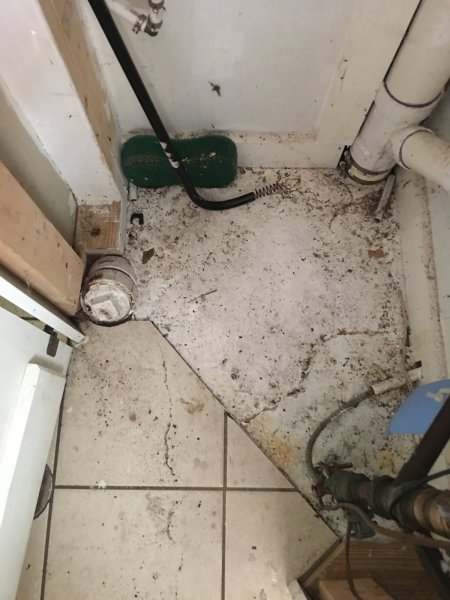

    It all started when we saw a puddle of water on the floor in the basement in the half bath / laundry and room. After checking all the water pipes and washing machine with no sign of a leak!

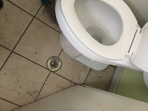

    Finally I noticed in this laundry room that turning the sink water on and flushing the toilet 3 times caused the backup and very large bubbles in the toilet! The water came out of the bottom of the toilet on the floor. Probably from the toilet Flange in the floor under the toilet. So after a while the water would eventually drain and the toilet could be flushed once or twice at the most with large bubbles.

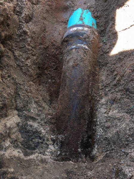

    Next I put a hose down and got pass the 10 foot problem area and turned on the 100 psi water full blast and it drained fine. Then I pulled the hose back less than 10 feet and again turned the water on full blast. Sure enough the pipe filled up and backed up on the floor! So the problem is at 10 feet or 8 feet from the front of the house approx 2 feet down. Got the shovel out and started digging. No water on the ground but this is close to where the new PVC line from the street sewer pipe connects to the old cast iron drain pipe into the foundation just below the concrete floor.
    After digging the connection looks good no sagging or collapse. See pic

    Pic 1 - iron drain pipe from house going into pvc pipe to street sewer
    Pic 2 - PVC cleanout that is in between pvc pipe to toilet and pvc pipe that connects to old iron pipe going to street. New PVC stack in back right corner that goes straight up to roof and second floor bathroom connects into it.
    Pic 3 - toilet right side where leak occurs and floor drain.

    I dug up the line in pic 3 and it is not leaking or broken.

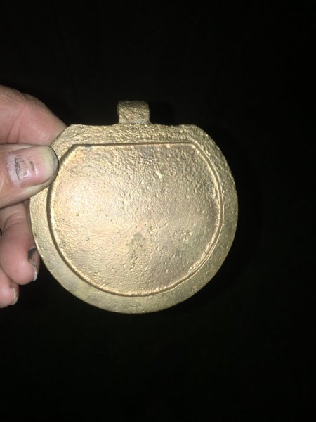

    I just found out something! My neighbor who lives behind me had the same problem and spent thousands and they found in the pipe 3 feet from the front of the house by the stairs Which routes in the place as my house a stuck flapper valve that broke off the hinge in the metal sewer pipe!!! This happened in Feb 2014 to my neighbor and he saved the flapper and I took a pic of it! They had to put a camera in the pipe to locate this flapper and cut out that section of pipe to fix it for $1500.00!!
    The valve was put in as a backflow preventer back in 1962!

    Those backflow preventer cause more problems than they solve, for most people...
