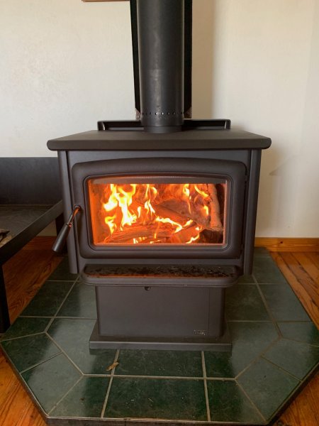

    Well, first fire in the new stove, today. So far so good. I currently have windows open and the attic fan running, trying to pull out the fumes from the new stove paint. The fumes are pretty strong. I guess this as good a day as any to do it. It's not really cold just slightly cool and the wife was a little cold, so I decided to fire it up, knowing I would have to open the windows, anyway, to pull out the new paint fumes. I let her roll for a while on high, then backed it off to about mid way, finally I cut it all of the way down, and I can see now that it has choked it down, pretty good. So, the stove damper is working decently, I think. I am going to open it back up some now, and continue to season the paint some more.

    That's a nice looking stove! Please understand that I'm not a stove expert by a long shot, but with a chimney that tall I would want a pipe damper for sure. I've got a 26' straight chimney with tons of draw as well, the stove closes down really tight, & I put a damper in just in case. I think the reason installers don't recommend them is because people may try & regulate a fire with it & defeat the stove's intended design & function. To my mind it's there only if something goes wrong, stove air control failure, leaky door gasket etc. Better to have it & never need it. Cheap insurance imo.
