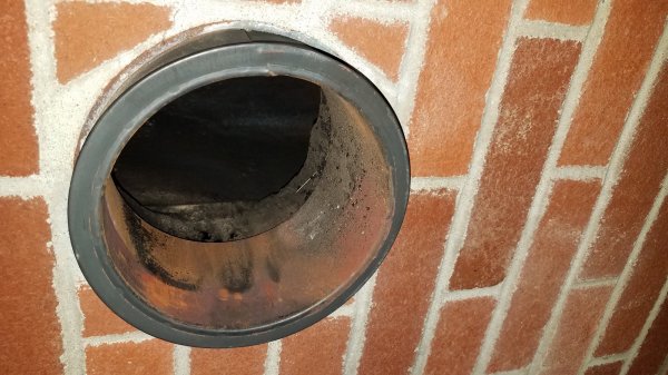

    I'm not sure how that would work. Here's a picture of my thimble. No way that's going to fit inside any 6" pipe.
    My existing stove pipe ends in a 90 degree elbow, with its straight female end inserted into this thimble. I haven't had any problems with creosote dripping down the outside of that pipe.
    As for the hearth pad, I've already got a non-combustible hearth. I was only going to use the pad if I needed to raise the stove a couple inches higher for a straight run between its vent and the thimble.
    Maina, Eric VW and Marvin like this.
  18. Maina
    Maina
    Feb 4, 2018
    1,618
    11,317
    Maine
    As long as the end of the pipe is inside the collar all the way you won’t have a problem. I thought you had a thimble coming out, and it’s common for people to install the pipe upside down.

    I think I may be confusing the terminology on this part. I wasn't sure if what's pictured there is the thimble or collar or something else. :)
    Whatever it's called, right now the straight (un-flared) female end of a 24 gauge elbow fits snugly into that opening. I'd like to upgrade to 22 gauge pipe, per Woodstock's recommendation, but I understand that most of the 22 gauge products have a wider flared female end to fit a smaller un-crimped male end. Do you think this wider female end will still fit into my thimble collar, and if not, would a male-to-male adapter be the solution to mate those connections?
    Maina likes this.
  20. Unhdsm
    Unhdsm
    Jan 30, 2014
    476
    1,455
    Bradford, Vermont
    It's hard to tell from your picture but I thought most Class A chimney pipe required an adaptor to transition to stove pipe. Maybe that's only for double wall stove pipe? It's all I've ever used.
