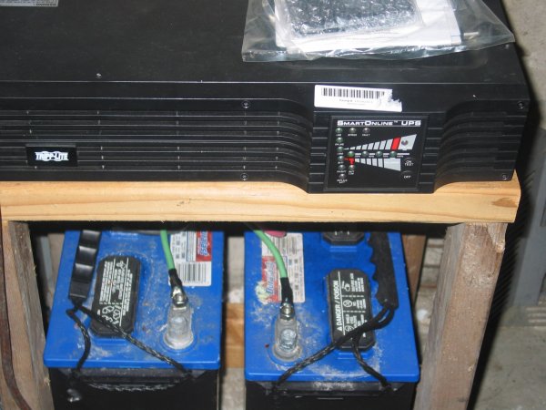

    Gonna have to ask the wifey if I can use the prime...........

    Jay....try to stick with "name brand" (Enersys, Sigmas Tek, Genesis, etc.) batteries...a lot of batteries branded after the name of the website are a crapshoot...IMO.

    Anybody ever use BatterySharks?

    No but I've been on that site. They seem to have decent prices plus you should get 10 off or so with your first order???

    Adding to Steve's recommendations :yes: - UPG brand ( UP1280I 2 pk.) batteries (12v, 8Ah) are surprisingly(!) long-life (2+/3yr) and (30$) CHEEP! :) @ the Amazonian site.. Have bought (5) 2 pks. from them this year, - not a bad battery in the bunch: all 12.65 - 12.87 v as shipped, all passed a standard 5 minute functional test after charging, and prior to being placed in service. :yes:
    Panasonic branded batteries @ [Batteries + Bulbs] local stores - check online for coupons, codes, etc. - if you can score these batteries on a deal (or needed in a pinch), they've always worked well for me. ... Genuine Panasonic is as good / or better than OEM.

    Woot, She's should be good to go know! Only blinked the 75% light green on start up and cruisin on medium heat(highest I normally run) on the 25% green light. Blinks as the auger turns(sounds soap opera ish even)......... She ran for 1/2 hour all green lights on internal(which are brandy new even). Hooked up the charged lead acids and it should be good for roughly a 6 hour run.......
    I'll charge up my AGM(more capicity) and get them on the stand. Should go a solid 8 hours plus with those....... :)
    Hopefully its the end of this story!! :) Me thirsty now!! :D
    :coldone: :coldone::coldone: and :drunk:
    Thanks for all the hints and tips fella's! :cheers:

    Power went out with all this wind. Stove ran for 3 hours or so until the power came back on. Battery indicator still said 80%
