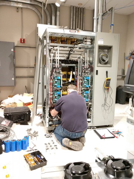

    That unit is at one of my Philly sites, it was due for it's 7 year caps (AC and DC) and fans replacement....per the manufacturer, Liebert (then Emerson now Vertiv). We just install a brand new unit at one of our other Philly sites (Vertiv 100kVA) and unfortunately these come from China now....I won't get started on that whole thing.
