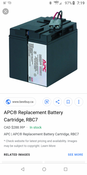

    Gonna need assistence on what connectors I can use for attaching more back up batteries!!
    See letter F in image.

    Jay... it'll be this... The external battery pack should already come with it

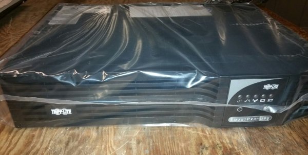

    Had a free minute tonight after work so I stopped over to the puter shop I used to ticker with. He's got a brand new in the box Tripp Lite SMART750RMXL2U I can have for $150 bucks!! :D
    :banana: :makeitrain" Now I just need to talk momma into it! :eek:

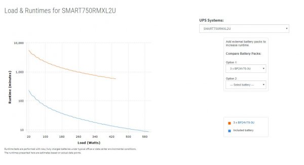

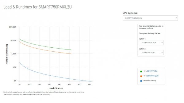

    I didn't read the fine print and it looks like the tripplite drops to 450 watts once you slave in extra battery capacity. It'l be close on start up............ o_O Maybe just use it like I initially intended and slave in a relay in the stat circuit so it just cycles off? I'll have to test it out good first!!
    Found the connectors, Seems us bass boat guys use them on the power poles(shallow water anchors)!! :D ordered a couple sets for $20 clams from the local marine dealer. Woot!!
    Edit: Forgot to post pictures last night. Here they are for proof. I'll pick it up on my way home tonight!! :) Start building a rack/stand for it between watching the rolex 24. :D

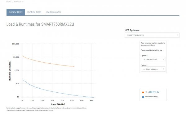

    CleanFire I know you said not to stab batteries into a UPS. But these units had me curious when I looked at the charts for optional storage. Seems they are way more expandable than I'll even need!! Popping in my 2 12v agms(24V in series) would be like adding 3 of the BP24V70-3U pack's. 70 is the AH rating, So 3 is approx 210 AH and the 2 AGM together would be really close. Just need to configure the UPS to 3 packs! :)

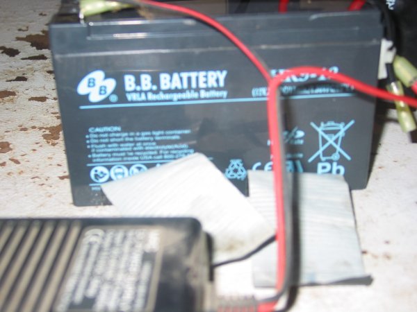

    Welp got the rack built and started playing. Found the unit would not turn on. Started checking battery voltage and they were "way" low. Charged all night and still no power on?? Pulled the batteries out and bench charging. Both were at 4 volts! o_O They are charging though......... Just wrenched the works. I'll bring them up to 9 volts with a low amp wall wart. Hoping the unit will begin to charge them after that??

    12v 9Ah
    I'll get the number and post after we fetch more pellets! Dinner first. Me starving!
    edit: Wifey is dillying..... SO! :)
    Pics of battery. Part number HR9-12
