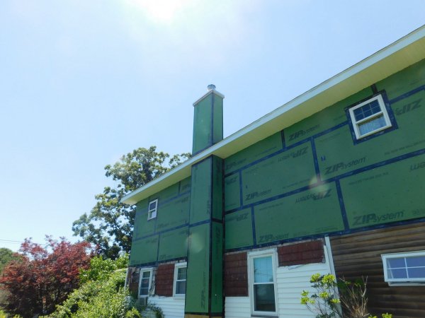

    I used a slightly different approach to do the exact same thing: run a new, S.S. chimney up the outside of my house. Mine is identical to yours except inside a chase. And I never would have done that if I were not already literally building a new second floor on my house, I would have done what you did.
    The chimney is 4" away from the house wall, the chase is 16" wide and the soffit is 24" wide so it appears that the chase 'cuts' right through the roof overhang; it does not do that, the chase is two built in two parts, one below the soffit and one above and there is no chase inside the house. There is a S.S. cap plate on top of the chase but eventually it will be covered with siding to match the house. Although I guess the Zip sheathing DOES match the house already. :)
    BTW: everything see in this photo, staring about 9" above the tall first floor windows, is new construction, inside and out. The house suffered a structural roof failure due to snow loads and so the roof needed to be replaced. But as the house is ancient post- and- beam construction, just building an new roof was not possible so new walls were required. And as there are no bearing walls inside the house (it is a 'magic' house) or at the outside walls, and the floor structure is inadequate, an entire new flooring system was installed ABOVE the existing first floor ceiling system; the second floor is not attached to anything inside the house and spans the entire 24' from outside wall to outside wall. Fast, easy and cheap.... yeah, it ain't none of those. :faint:;):D

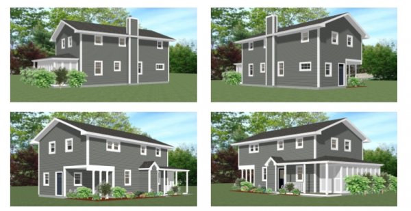

    And as I said, if I had an already finished house as you do, I would probably do the same thing. Adding a chase is a bit involved, requires hacking into and refinishing both the house siding as well as a piece of the roof, and usually requires gutter be cut and that is an entire 'can of worms' in itself. Which is exactly why the chase on my house is narrower than the soffits, and one reason why the soffits are so wide in the first place.
    And frankly I am more than a little wary of what that chase will look like when finished. The house will be medium or a touch darker gray with white trim, and that chase will be fully trimmed on top and all four (two on the side of the house) and I am afraid it will stand out like, well, like a gigantic chimney chase! I made it 40" wide so it would not look like a ridiculously tall telephone booth and am hoping that aspect ratio, 16" deep X 40" wide looks as [not odd and not 'funny'] as possible.
    A lot of the house's design has been done to avoid it being 'funny' looking rather than to achieve something positive. To be brutally honest, this is our last shot at this house or any substantial building or re- building project, and because it is so all- encompassing, it has been a real challenge, at least for me, to avoid the proverbial 'stepping in it' as we go along. Honestly, I am not a negative person but this whole project has my hair standing on end waiting for the hammer- blow that something atrocious will (or already has and we just do not yet know it) happen. Now, all of that negative thinking aside, so far it is turning out fantastically, way overbuilt and robust, with a tremendous amount of thought and agonizing in all facets that are coming together into a very human- friendly, very good service house I think. This is what we are aiming at eventually:
    Note: the woodstove uses a new S.S. chimeny in the center of the house and it has its own 3' tall chase just off the center of the house. That chase is 20" square and will also be sided and trimmed to match the house.
    Brian
    brenndatomu and Eric VW like this.

    I think it looks great, I know what will look good when finished and what won't lol. It certainly looks like you have yourself on the right track to pulling it all together nicely. What type of siding are you going to be using? Cement board, cedar?

    Nope, vinyl. Yep, the cheap, junky but functional and maintenance free vinyl siding. That way the vinyl can sit on the house and I can ignore it to cut firewood! <big grin> The plan is for around the windows and probably for the outside 90 is to use 'plank' vinyl dimensional pieces. More expensive but truly maintenance free and they clean up like new (at least in white). I did cover the first addition to the building with #1 VG cedar clap board and while it looked stunning, it required far too much maintenance for us. Bought and played around with some cementitious 'clap board' and while it is not hugely expensive, it still requires paint and other maintenance so we have a winner in vinyl. Not likely to occur this year anyway; working on the interior this year. And we need an entire staircase between floors so that will be a major undertaking as well, especially trying to keep the construction mess out of the first floor :-(
