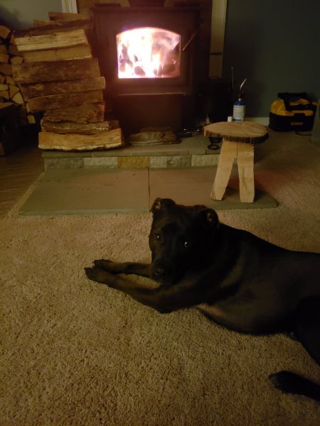

    20190112_181606.jpg I try to keep a couple days worth by the stove. I know, some of you will say it's too close. but the way the stove is made there is an air gap between the stove box itself and the outer panel. I have checked the temp with the stove at it's hottest, and the wood next to it doesn't get above 120f.

    Mine had a similar gap too, would get warm but never super hot so I think you’re ok.. if it were a Schrader or Fisher stove then no.
