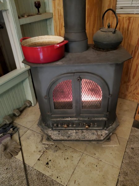

    A friend called last night, and was afraid she was overfiring her wood stove, with 2 logs and 200° stack temp.
    She's newly a widdow, and "cleaned" the chimney herself.
    We're going over this afternoon to see the setup....what she has for wood, chimney lined or not, etc.
    The location looks like an uninsulated summer place, and wood walls pretty close by.
    Everything advice-wise will be assuming the chimney is clean, no creosote, is burning dry wood.
    She sent us a pic of the stove. Any of yall ID it/have a general idea of its capabilities?
    Thanks!

    It looks like a Garrison 2 or 3 depending on size , which were actually a pretty nice stove. The only piece I'm not familiar with is the front "draft vents". My vents on perhaps a older model, were on the rear in the corners on the back of the stove and the input air could then flow down and under the load.
    Still, I'm quite sure it is a Garrison. Soapstone interior, and quite a decent stove pre EPA stoves of today. I bought mine when I built my house in 1979.
    Made in Claremont NH, I think some of the folks who used to work at Vermont Castings started this business.
    This thread should probably be moved to non-EPA stoves.

    Unless you can find a data tag on the back that says otherwise, that stove is very likely too close to the walls...

    That one would make me very nervous ....

    Idk, heat shields on walls, and double brush the pipe, and extend the hearth, but not sure that would be adequate either, so close to the walls :confused:. I wonder how she measured the stack temp? Maybe pick up a couple magnetic thermometers for her on the way there? Does she live there and is this primary or secondary heat?

    Not sure on the stove model but I'm gonna say straight up she needs more clearance and also some kind of fire barrier around that back and side, as well as a better hearth setup. That would never meet code, at least where I live.
    Looks like an 8" reduced to a 6" right out of the top, so that puppy probably can put out some serious BTU's! Good on you for helping her out and giving it a proper look.

    I concur with the hearth and clearance issues. With or without a tag, it looks too close for any code.
    If I had to guess, PT residence, only source of heat....meant to take the chill of, not as a primary all winter. I mean who puts a wood stove near a cold sink like a window, except in a cottage? That and what appears to be an uninsulated wall.
    I have no idea what we're walking into.

    The Garrison 1 looks pretty close to what this is.
    The baffle in this stove is a rigged piece of steel. But it seems to work.
    It is shielded, but that windowsill is 10" out. And its an interior wall.
    The woodork is pretty darn close....18"on the right side.
    This passed muster with the town inspector!!
    I suggested that she look up the regs for pre-epa stoves clearances (which here are a set number if there is no tag), and extend the hearth to 18"-20" in front of the door.
    The wood she's burning looks good, and the whole chimney is steel with a cleanout inside the house.
    This stove burns hot and takes very little time to heat the space. It is indeed a smoke dragon. The space to be heated is small, it is a summer cottage.
    Thanks to all I have learned here, we were able to talk intelligently about burning hot, using wood volume to control temp, and when to close down the air intake, among a host of other things.

    Taking another look at that picture, it probably is the Garrison One. Which was the largest of their stoves. With a full load, it would burn all night easily. Did it not have the round steel plates on both upper rear corners that screw in/out to control intake draft?

    I dont think it had but perhaps one steel plate, I thought it was a trivet I was looking at. Air intakes are in front of the ash drawer.
    It burned hot on 2 logs and kindling, and the place is tiny, so it roasts one out pretty quickly.

    I don’t believe that is a Garrison. I could be wrong, but I’m pretty sure. Air vents at the bottom of wood stove doors was pretty common back then, but they were “in” the load doors and very few had a separate ash pan door let alone an ash pan door with vents.
    A lower ash door suggests an ash pan for coal. So does the vents at the bottom of each corner of the stove (look closely), as well as the heavier ash lip, and looking through the glass it appears there could be a coal retaining bar behind the glass. I’m guessing this wasn’t a straight up coal or straight up wood stove, but maybe a wood/coal stove, or duel fuel stove of some brand.
    Pictures of the inside of the stove would confirm or deny my suspicions. Like I said, I could be wrong.
    EDIT:
    Maybe it’s a Garrison wood/coal stove.
    garrison wood stove images - Google Search
    The link leads to a competitor site. Hope it’s ok to give the link here. Garrison Stoves
    2nd EDIT:
    :rofl: :lol: Looks like we might both be right. Follow the link. Who’d have thunk it! They did make a duel fuel stove.

    It very well could be a Garrison coal stove which from what little I have read this evening was likely a wood/coal model and called a coal model.
    Still, the ash lip and the doors are different than any picture of Garrison’s that I have seen.
    Still could be another brand stove, but it’s looking like it very well could be a Garrison coal stove...a duel fuel stove. An attempt at a coal stove from a wood stove frame of mind and design...which usually isn’t built quite well enough when compared to those coal stoves of the same era with a better reputation as a coal stove. Glacier Bay/Gibraltor stoves being two names from that era that come to mind that had better reputations, still do, as being stoves built like tanks.
