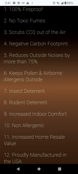

    I may have mentioned this before, but anyone set on spray foam needs to look into Airkrete...all the advantages of spray foam, none of the problems.
    Home | Airkrete - All Green Light Weight Cement Insulation!
