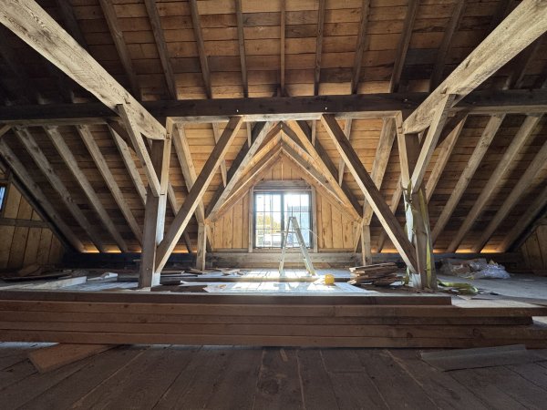

    The biggest is I wish we had done the barn before the house. Def leveled up my timber frame skills, so the barns a real beauty.

  19. MeanJoe
    MeanJoe
    Jan 31, 2016
    321
    1,988
    Western Michigan
    This is top notch work!
