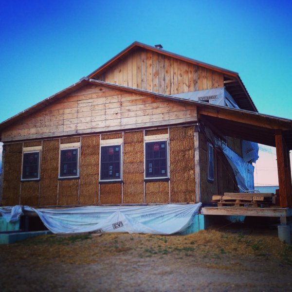

    Not a single sheet of ply or osb in this joint.

    I think it was in the 80's that I first learned of those.
    What an haven for insects/vermin! :jaw: :hair:

    On the contrary, haven't had a mouse in the house in the 10 years since we moved in. :sherlock:The bales are so tightly stacked, and plastered solid inside and out, there's no entrance point for them to get into the non-existant wall cavity. Where as with a conventionally built house w/bat insulation, and holes drilled in studs for wires, you've created a rodent super highway :D
    The 2 things most folks jump to is rodent/insect and fire concerns. Once researched, you'll find both are non issues. The only real trouble I've had w/the place is fairly regular exterior plaster repairs. That's mostly my fault though, the finish coat didn't have the proper sharpness of sand, so it's been weak, and I've had to flake off and repair various small sections.

    You win the week. I’ve never seen a house built with bales like that! I’m sure it’s fine if it is properly waterproofed but is water intrusion a concern? Any ways to monitor that?

    Water intrusion is bad for pretty much any wall system I know of. The best analogy out there for this wall system would be a typical stud wall with dense pack cellulose. Straw is essentially the same thing. I'm not aware of anyone monitoring their stud cavities, but we did a few things to mitigate as much as possible.
    1 large overhangs (2 foot)
    2 The basement stem walls poke at least 18" out of the ground, so there's no splash back onto the bales.
    Other than that, just a house with 2' thick walls that takes a candle to heat. Even in a cold year like this year, I'm on target for 1.3 to 1.5 cords through the keystone.

    How about MC of the bales?
    Do they retain moisture?
    Leading to mold issues?

    Good thing about straw is that if it gets wet, it can dry, given a chance...hay bales on the other hand tend to stay wet, and then mold.
