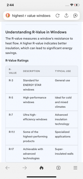

    So everyone understands, it’s been a few years, I am not against high energy efficient windows. BUT in the classes I took the most efficient house is one without windows and doors.. it’s just real hard to get into;)
    most can’t buy a window over an R7, and 3.5” of fiberglass insulation is usually R11-13.
    When building everything is a cost to performance decision. What do owners believe have value to them, they are paying for it.
    My point is it’s way easier to spend money on drainage and insulation below grade and behind walls now! I will say it again, it is my opinion that cabinets, floor covering, countertops and Windows and doors are easiest upgrades.
