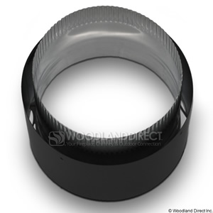

    A double wall stove pipe , like said is the black "flue" pipe used inside the house It's a pipe inside a pipe with an air space in-between, it keeps the inside of the pipe hotter and the out side cooler , so It can be closer to combustible materials . A single wall is just that , single wall
    Double wall looks like this
