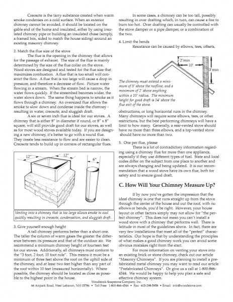

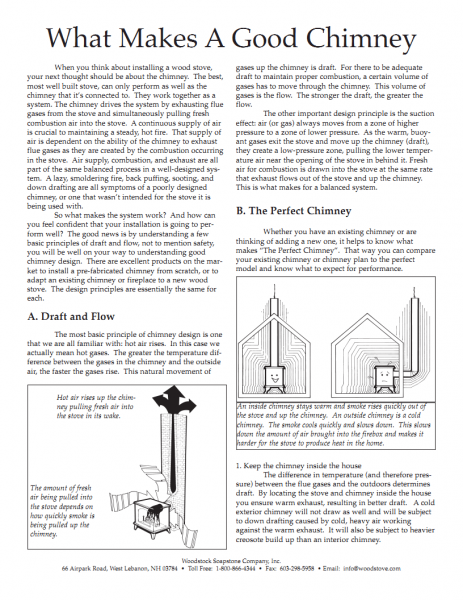

  13. HDRock
    17,268
    60,521
    Here is a little something for you to read

    60,521
    :yes:
    Eric VW, fox9988 and wildwest like this.

    30,716
    145,025
    WOW, great post. You are generous to take the time to write it down to share, and you have a way with words that make it understandable for everyone. :yes:
    fox9988 and Canadian border VT like this.
