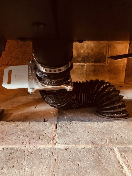

    Happy to report an INTAKE damper, at least on a Hearthstone Heritage, works! I now have full control over the burn, and don't have to worry about overtemps anymore. :thumbs:
    Yes, no doubt manufactures build their stoves to achieve their best results in the testing environment with a 15' chimney. I'm sitting at 31', so damping is a must.

    I 100% agree. I have a very similar setup and the first night it hit single digits here running the Ideal steel it nearly scared me. Thankfully I had the OAK installed and dampened it there. I added it just a few days after that incident. The amount of control gained by adding a stack damper is very useful.
