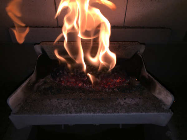

    For comparison purposes, here is the burn pot after 6 hours of burning stove chow:
    This is after burning combined Vermonts and Okie DF for 15 hours.
    There were some Vermonts in the hopper and I dumped a bag of Okie DFs right on top of them.

    Yikes, I thought the Harman is supposed to only have an inch of ash? Is that correct? That looks like a lot more than that.

    Does the ash eventually fall off the front or does it just build up?

    It will fall off, right now mine has a build on the lip ,but I can still see most of the burn pot holes through the ash , like pizz holes in the snow .
    The softies I burned this year ,my burn pot was similar to td bergs I think because the softies ash compared to hardwood ash is less by volume and weight so it just blows out of the pot and doesn't build up .
    From my Harman manual " If at the #6 setting [ feed rate] a 1" ash bed is not obtainable ,it is not a problem. The 1" ash bed is only a maximum burn rate and at most normal setting the ash bed will be larger.
