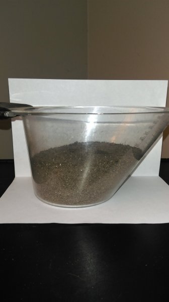

    Stove Chow Wood Pellets results: FINAL RESULTS
    Temp Average - 280-340 (on door thermometer)
    Ash Volume - 16 ounces
    Ash Weight – 2.35 ounces
    Ash Percentage - .37%
    Fines In Bag – less than 1/8 of a cup
    Pellet Length Avg. – 1/4" – ¾”
    Bag Weight – 40.2 lbs. (zero oz. left in hopper)
    Notes:
    $239 a ton from Home Depot
    Next to no fines in the bag
    Small diameter pellets
    Developed half-dollar sized clinker
    Are these Energex Hardwoods???
    I read a comment somewhere that this year’s Chows burn “hot as hell”. I’m not sure about that but these put out pretty decent heat with a moderate amount of dark, coarse, fluffy ash. The pellets are very dark in color and similar to the PTL’s that I burned last year but not quite as dark. The one thing I noticed was these pellets being a smaller diameter than I remember. I wonder if they changed the dies up at the factory??? The diameter looks the same as ‘Sets, Turman, etc. These are usually very abundant in our area so I know a lot of people probably burn these as their main pellet.
    All in all I would consider these an average to maybe a tick above average pellet this year (at least the bags I have). Definitely a good “shoulder” pellet.
    Recommend!
    Disclaimer:as with everything....YOUR MILEAGE MAY VARY....the reviews are just my opinion of them
