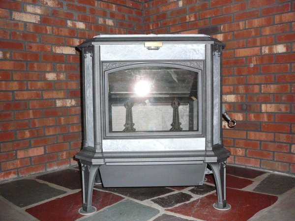

    I have little experience with wood stoves but from reading what folks have to say about Woodstock and their performance and being nothing short of artwork to look at, that would be at the top of my list for sure.

    Note that Woodstock has exceptional customer service and products IF you like the styles ( she did not ). Well worth the visit to their plant. And, they offer an unlimited 6 month return !

    sounds like a Woodstock Soapstone or similar type cat stove would be a good fit.

    Sounds like the perfect application for a Woodstock Fireview. Cat stove so it can simmer. Soapstone so it’s an even smooth warmth. Problem is no dealers and NH is a long way from Arizona. They would need to know that is THE stove they want and buy it unseen and ship. Some people can do that, others want to kick tires. With a Woodstock your tires never go flat ;) :)
