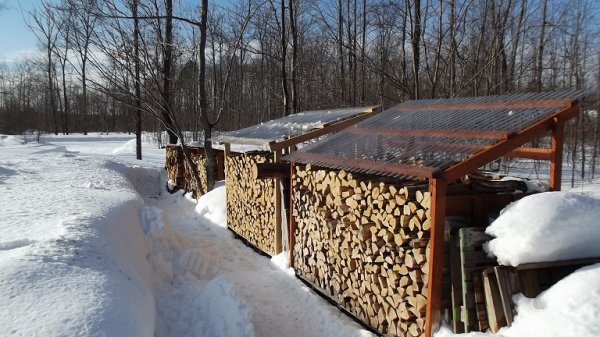

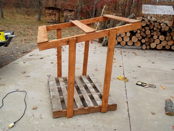

    To improve your wood situation you might want to build an outdoor storage rack like this... I topped it with some scrap roof tin I salvaged from our local recycling center (dump). They're small enough that I can move them around if I need too. Each one holds just about 1 face cord, 4'x8'x16", 2 rows 4'w x 4'h. I say "about" because the side boards are a little short on this one. I've built a few from free pallets, scrap 2x4s and salvaged tin.

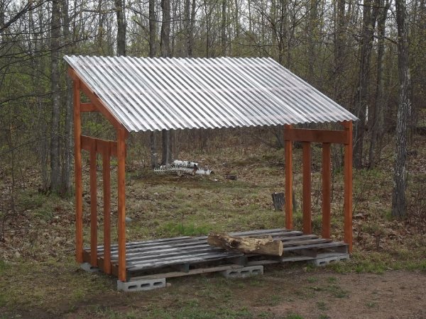

    Or a bigger one like this.... Depending on the pallet size, it's about 7'x4' and 4' to the bottom of the front of the roof....

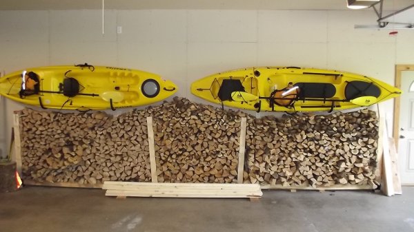

    I let my wood dry/season outside in the sun and wind, then bring a winters worth into the garage so I don't have to drag it through the deep snows.
    I think it's also important to store the garage wood off the concrete floor... I've never noticed an insect problem. I think drying outside drives them out of the wood, and the cats deal with any 4 legged wood pile visitors.

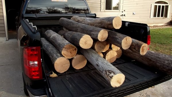

    I've noticed that my splits seem small compared some, but my main source of wood is dead, bark-less, darn near dry, wind fallen oak. Most of the logs are under 12" diameter, many 6" or so...
