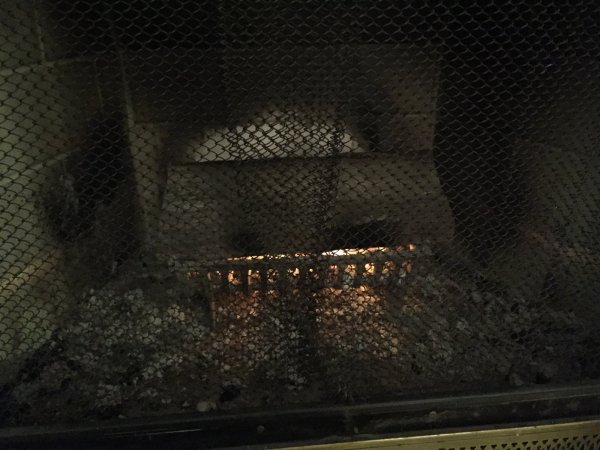

    Just started a fire with the "dry wood" from

    So far no good...its sizzling bubbles out the side and u can hear it sizzling. Although I literally took it straight fRom outside and tried grabbing the dryest pieces even tho they felt a tad wet

    I'd split some smaller. Like 1 inch or 2 max. Use those to start the fire. You need some coals to develop. Then use the bigger pieces like in the pic.
    If it's oak, it's gonna sizzle. That's stuff takes forever to dry
