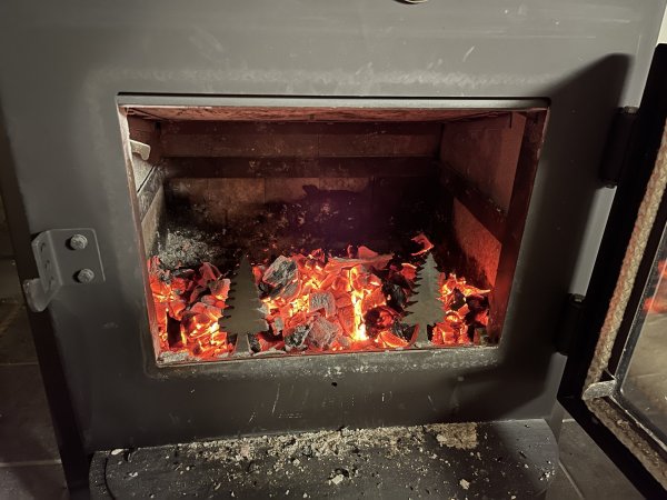

  20. Barcroftb
    Barcroftb
    Sep 30, 2015
    3,162
    18,652
    The Mitten
    oldspark there is an air hole that feeds the bottom of the air box. It’s located in the middle below the door gasket here: 9E01CD9D-CA5B-4F0A-A6B8-B700D4D46B93.jpeg
    it feeds into a channel below the andirons and it does collect ash under there. Ask me how I know:emb:
    Edit: disregard I see you’re running the AS Nitrodave
