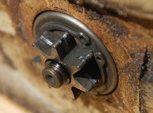

  6. dougand3
    dougand3
    Aug 6, 2015
    336
    1,224
    North Alabama
    The sprocket in #22....I'd say borderline that it will max out pin tensioner. Maybe you had a bar/chain mismatch somehow or REALLY stretched chain. I've run sprockets like that or maybe even worse. yuk yuk.

  7. cootcraig
    cootcraig
    Dec 30, 2017
    56
    100
    E. of Pueblo, Colorado
    I haven't run this saw. That is how it was sold to me. I don't know what chain is on there.
