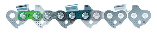

    Can someone post some pics of the different types (ie: RM vs RS) ? :ithappened:

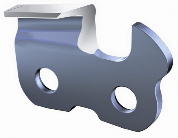

    Kind of hard to see the difference from Stihls pics. The RS is full chisel?

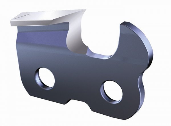

    yes rs is full chisel, rm is semi chisel. i just bought 2 rmf (semi chisel full skip) chains as all of the stuff I cut is scrounged and has been in the dirt and I am hoping the chains last longer between sharpenings

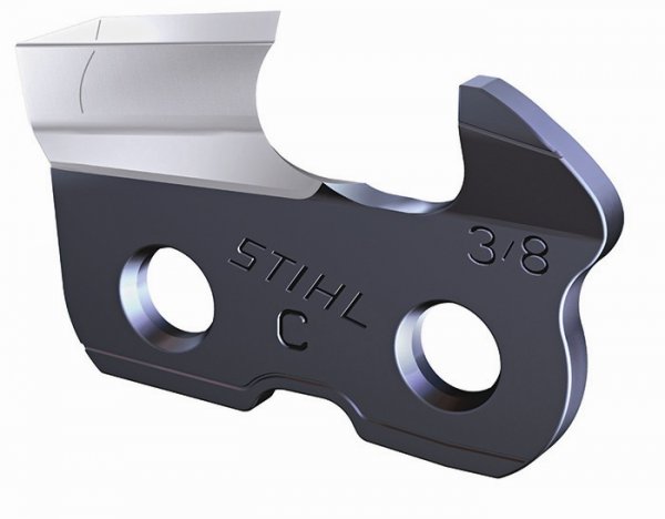

    closer up:
    RS
    RM

    Same cutter on the RS3 & the RM3
    Just have a hump on the link that comes up when the chain goes over the nose of the bar to reduce kick back potential.
    Work good for liming & most cutting, works for bore cuts too, just not take as big of a bite.

    and well have the green color coded link

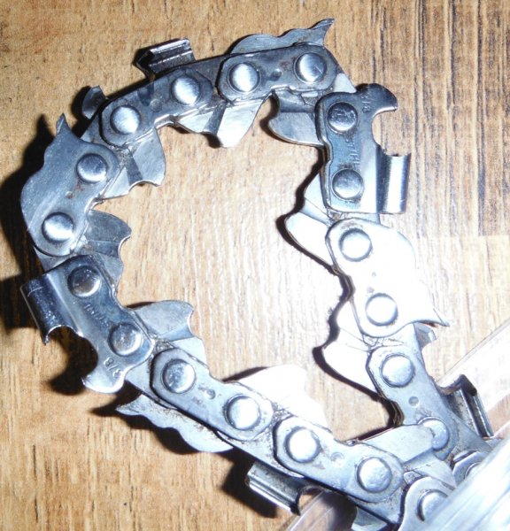

    Old RM with safety hump . safety chain ,
    RM3 green chain now. different safety hump design now too.
    Shawn Curry and StihlHead like this.
  9. bogydave
    That old chain shows why I started hand filing my own.
    Took several to a local sharpener & got back burred & burnt cutter tips.
    over heated the tips & took the temper out ,
    ground them down fast & has bad burrs

    That is RM2 in the photo there. Semi-chisel with the big-azz safety rakers. They do not make that any more. They make safety rakers now that overlap the cuter rakers on the flats and open up when they go around the tip to increase the raker length and hence the safety aspect (less kickback that way).
    clemsonfor likes this.
  12. bogydave
    New it was old , RM2 eh. Not sure how long I've had it or where I got it :)
    Still usable in a pinch, but burned cutter tips will prob dull fast.

    I have several loops of it. Stihl saws here used to come standard with RM2. I use it for cutting potential naily yard trees, fence posts and the like. They used to make an RM with the same cutters w/o the safety straps, and that was good stuff. I still have some of that. The new RM is what was called RMC. The guys at Stihl like to really confuse things, especially when it comes to chain.
