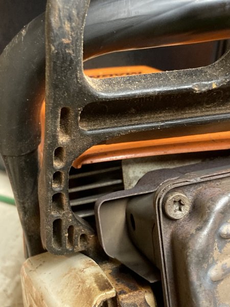

    I looked at the stock picture and it does not seem familiar. I almost think the saw did not have the heat shield to begin with but I'm not 100% sure.
    It's a pretty distinct heat shield with those 3 protruding nubs so I feel like I would have remembered handling it and it does not look familiar at all. I thought perhaps I got something mixed up with the 660 but that heat shield looks completely different.

    I believe that’s a hiway muffler on the 460. OEM has the screen on the inside and doesn’t require a screw. I’m not certain what pitch the threads are on it or if it’s just a sheet metal screw.

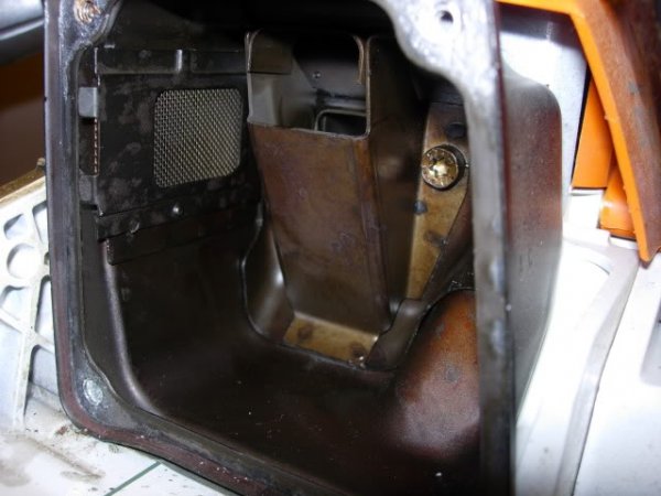

    460 mufflers have an internal screen with tabs that fold over it to hold it in. The dual port cover has a screw as in the top picture. Not that it’s an issue. I’ve never had a problem with hiway mufflers.
    OEM 460 mufflers look like this
    The 044/440 has the same muffler but without the baffle and it has a slightly different deflector on it just for reference. I’m not certain if all 460’s had the cooling plate in them or not. I would put it in if I had one, but it’s not in all of them, so I don’t believe it’s an issue

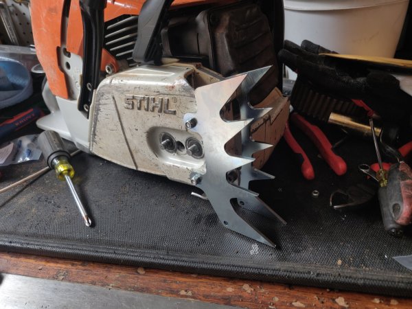

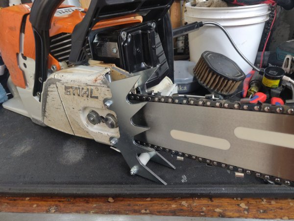

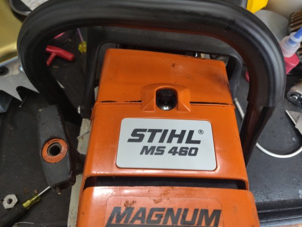

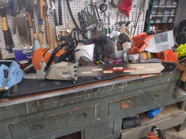

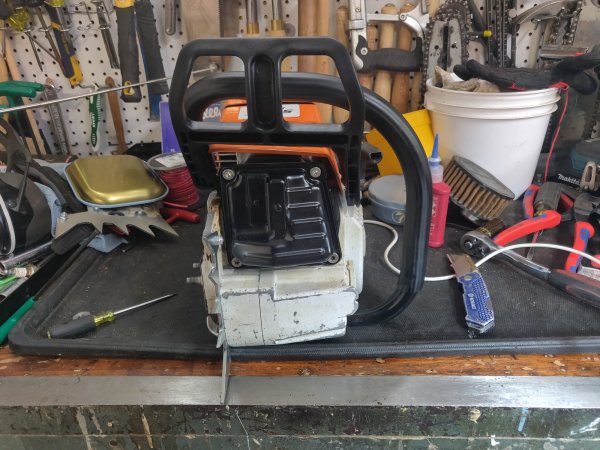

    1. Heat shield for muffler installed along with the Hyway dual port. The muffler was a little rusty inside. Not cool.

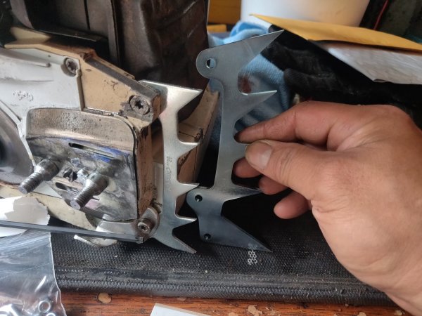

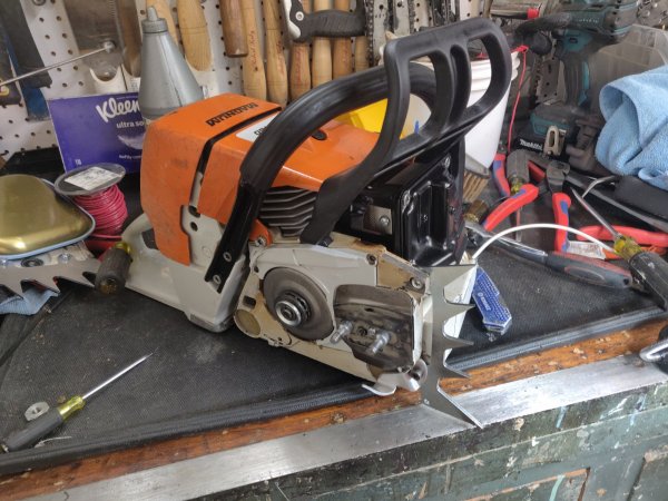

    2. Larger AM dog spike set installed. Man these are legit. Not thin at all. Super heavy duty. Compensates for the light powerhead and the 28" bar. Now the saw doesn't fall forward on the ground.
    3. New MS460 nameplate. I need to put a dab of hot glue on there. One side is popping up.
    4. Rolling chain catch installed. Since I had originally ordered the metal one I just left it on there as well.
    Can't wait to test it out today. Going to tune it according to MasterMech's video to the letter.
    I have to clean up my bench.
    Stock inner dog vs larger one.

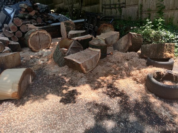

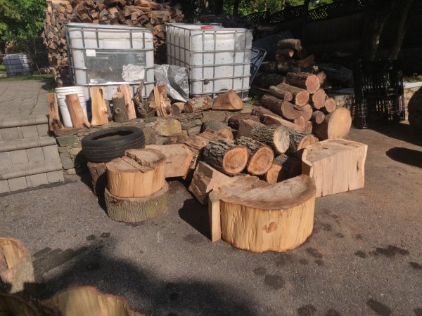

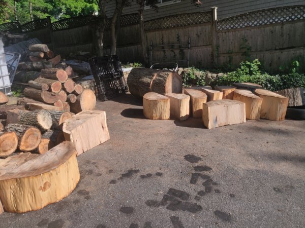

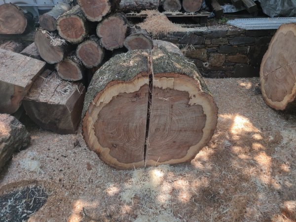

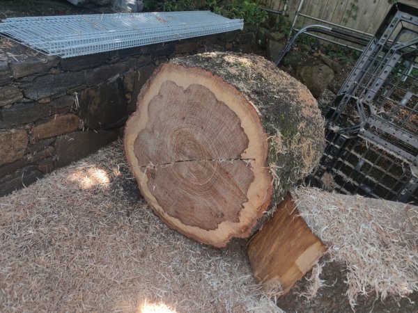

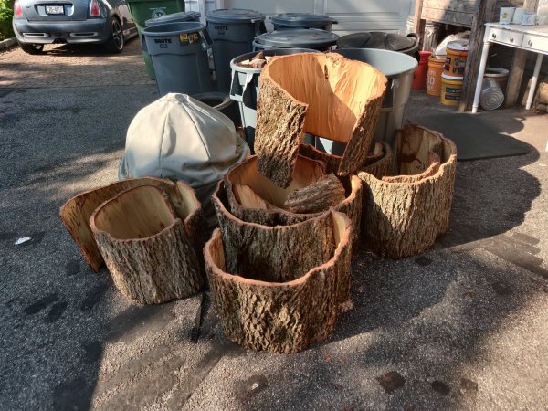

    Thanks man. I bucked up the rest of the hickory logs. I still need to noodle 3 of the rounds. It was damm hot yesterday so I ran out of gas (get it?).
    I had the GoPro out so I'm going to edit the footage. I think I set the H jet too rich as it bogged down a little bit and also was revving up a little higher after WOT (3200rpm vs 2500rpm). But overall I'm super stoked because it didn't blow up! :D I also sprayed some brake cleaner in the clutch and flywheel area to make sure them seals were not leaking and fingers crossed it passed that test.
    I still have the limited in the carb adjustment screws so I may remove those since this is going to be my saw - and nobody is going to use it except for me!
    Here are a few pics for now.

    I don't know what species that wood is , but it Looks Hard !!
    All nice and swept up . I like the bark (rounds) !

    Yeah it's hard alright! Hickory! First time ever getting it talk about being thrown directly into the fire!
    I do have to tinker with the carb a bit more for sure. Also it was like 95 degrees out that first day....I just saw a video of a guy who put a larger jet into the carb to match the "stock" jet that you get from an overseas version of the 460. But I don't think I need to do that.....Gonna see how it goes with just the dual port muffler for now.
    I wish I could do more with the bark but I just can't think of anything to do with it...

    Cut it into slabs and let it dry, mix it in with the wood. Burns hot. It doesn't break down or rot like some other bark. I used some hickory bark to fill in holes in the woodyard, drive over it, been there close to 2 years. Tough stuff.
