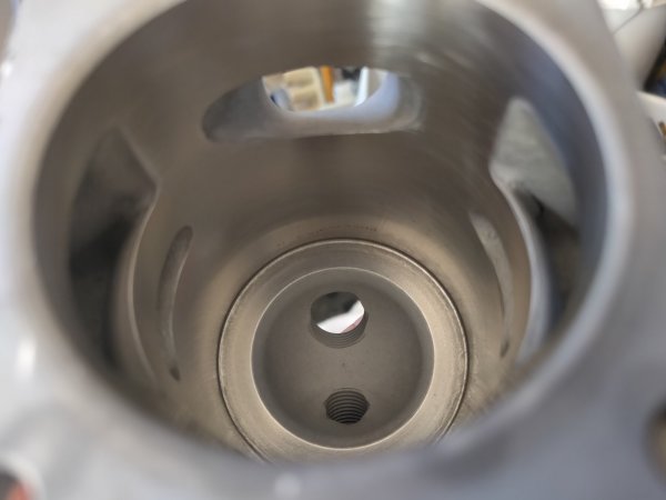

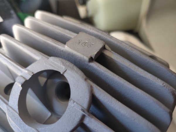

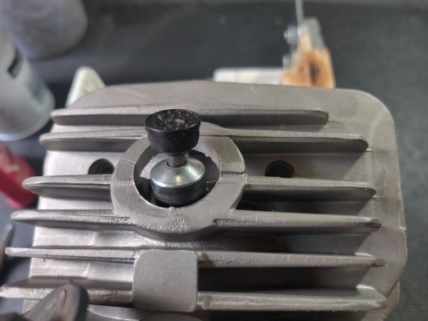

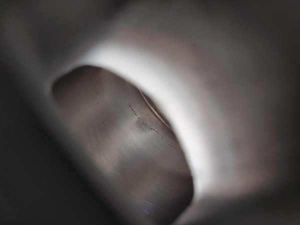

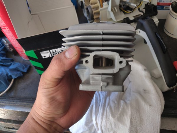

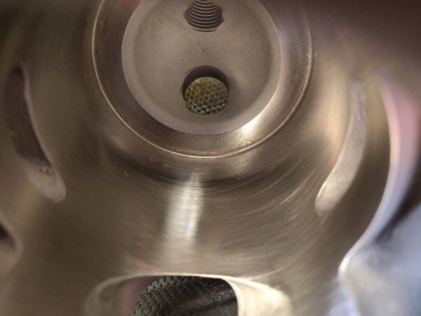

    I got all excited because UPS delivered the Meteor piston and cylinder kit........
    And this is what I saw when I examined the cylinder...... :headbang::hair::doh:
    PITTING. On the inside of the cylinder walls......as if some acid was not cleaned off properly.
    Called up the vendor and they are sending me a new kit. The hyway kit had a piston with a huge scratch on it and now this. I can't believe my luck.

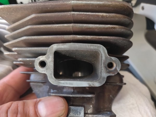

    I'm also not too pleased with how wonky the exhaust port looks. Compared it to OEM which is nice and straight and slightly larger too.
    Meteor on the left below, OEM on the right.
    Kudos to the vendor for sending me two return labels.....but I think maybe they should check their kits before shipping them out. I mean it was very obvious to me the second I opened the box.
    There was also a sharp edge on top of the cylinder too. Not cool.
    So now I have to wait some more until I can continue building the MS460. Ugh.

    Aftermarket cylinders are… typically… no where near OEM quality.

    Ready to sell me that old junk oem cylinder yet?
    You’ll learn soon enough. Most Asian stuff isn’t worth the ibuprofen that it took to get rid of the headache. Especially if it doesn’t outrun your 034 Super

    The Hyway cylinder looked pretty spot on. I'm sure someone could find fault with something but for the price I'm willing to experimentate a little. Let's see how it goes.
    The compression is pretty ridiculous.
    The cylinder has some scoring on the exhaust side that I can feel with my fingernail. Still interested?

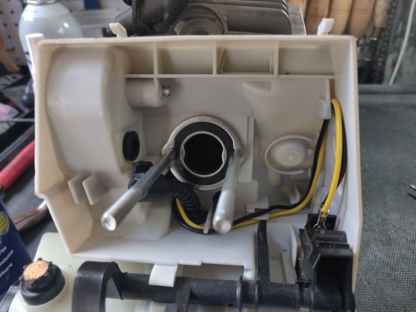

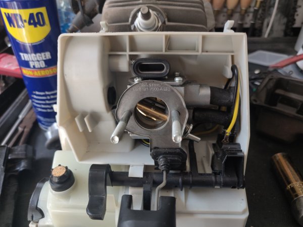

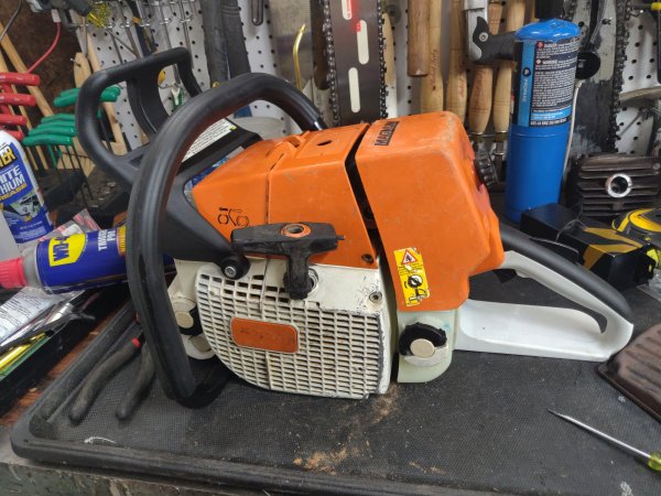

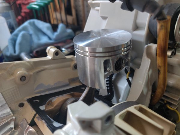

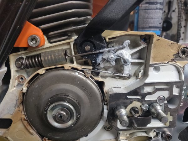

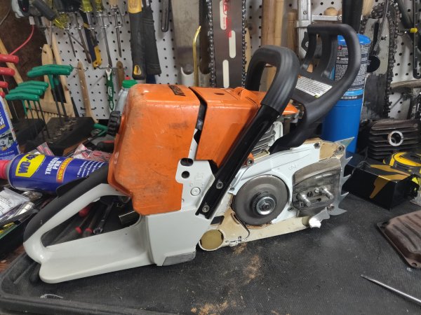

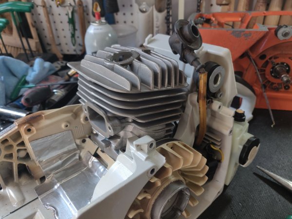

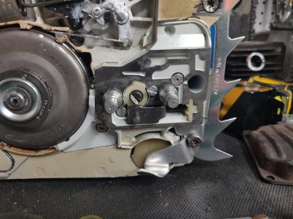

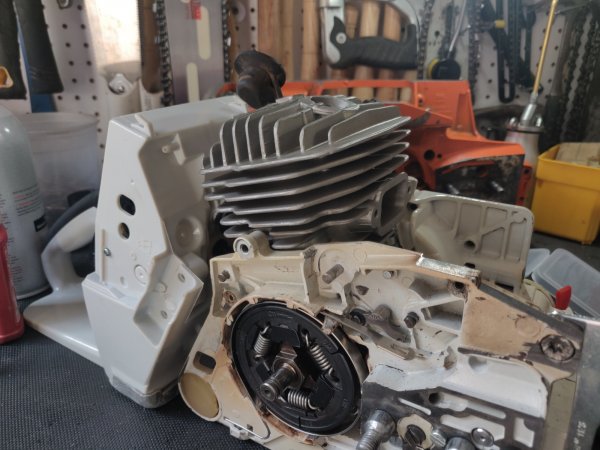

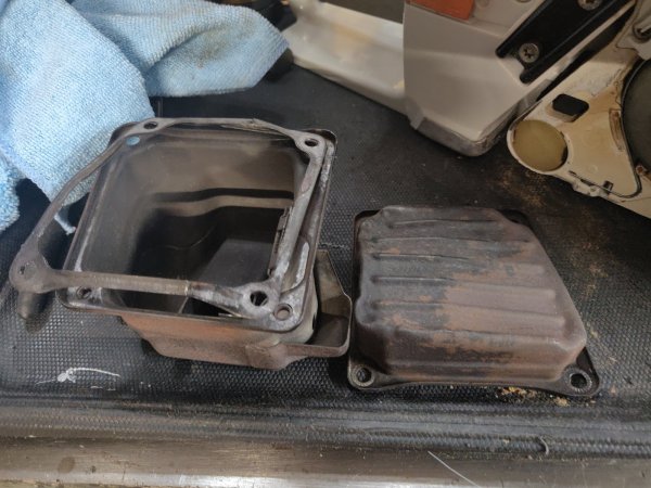

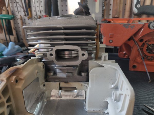

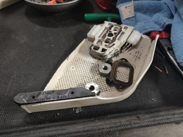

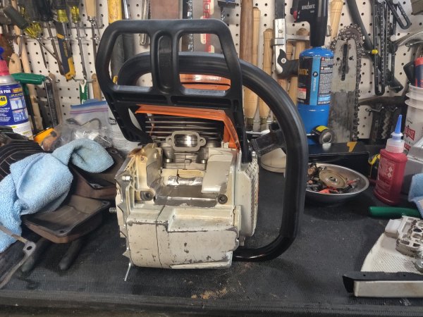

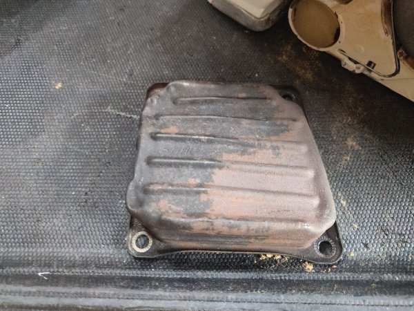

    I put together the MS460 today. For some reason I lost the spark arrestor for the muffler, the screw for the spark arrestor and I also seem to have misplaced the muffler-to-cylinder bolts as well as the muffler heat shield. I was tearing the garage apart looking for it but I'm tired so I'll leave that for tomorrow. They've all got to be together somewhere wtf.
    So I wonder where I put the darn spark arrestor. The front of the muffler has a huge dent in it and it's rusty and ugly. I may be tempted to order a dual port Hyway one for $32.
    I did remember to reinstall the snap ring below the worm gear for the oil pump. I also made sure I had the correct length screws for the oil pump so I wouldn't puncture the case.
    It's kind of annoying me that I misplaced that spark arrestor. I specifically recall removing a spark arrestor to clean it...but now I can't remember if it was for this saw or not.
    2022-05-15 14.48.31.jpg 2022-05-15 15.04.01.jpg 2022-05-15 15.04.11.jpg 2022-05-15 15.04.14.jpg 2022-05-15 15.07.02.jpg 2022-05-15 15.07.07.jpg 2022-05-15 15.46.49.jpg 2022-05-15 20.59.50.jpg 2022-05-15 20.59.52.jpg 2022-05-15 21.05.21.jpg 2022-05-15 21.05.28.jpg 2022-05-15 21.48.18.jpg 2022-05-15 21.48.26.jpg 2022-05-15 21.48.40.jpg 2022-05-15 21.48.53.jpg
  17. LordOfTheFlies
    LordOfTheFlies
    Apr 5, 2019
    2,519
    12,101
    NY
    Parts list:
    Oem chain brake handle
    Hyway p/c kit 52mm
    New clutch needle bearing
    New air filter
    New oem chain brake plastic covers (1 large, 1 small)
    New oem plastic chain guides on clutch cover.
    Farmertec fuel tank/handle
    Farmertec wrap handle
    Tsumura 28" lightweight bar
    Stihl 33RS91 28" 3/8" .050" gauge chain
    NGK spark plug
    Tomorrow I find the damm parts I lost and then I'm gonna start her up!
